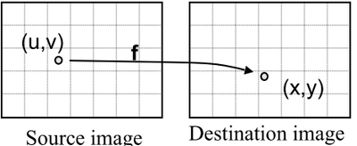

Check i.MX8QXP RM, Blit Engine support Image Warp as: “Performs a re-sampling of the source image with any pattern. The sample point positions are read from a compressed coordinate buffer.”
So you need prepare two input buffers, one buffer store original image data, the other buffer store resample point coordinate, DPU blit engine will read that two buffer by fetchwarp9 unit, then output result image buffer which contain warped image data.

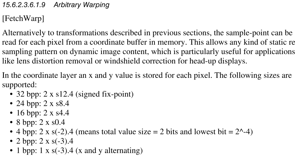

The resample point coordinate buffer contents is depend on what kind warp transformation in your use case; and for each resample point coordinate format check i.MX8QXP RM fecthwarp unit description as below. In this doc, using the 2xs12.4 format, each point x coordinate use (12+4) bit, same as y coordinate.2.png2.png

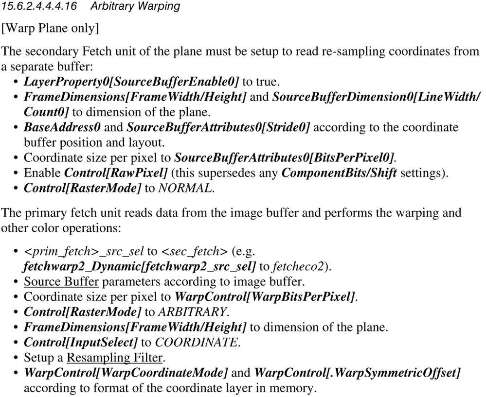

For DPU fetchwarp9 unit, to enable it work for image warp, check i.MX8QXP RM:

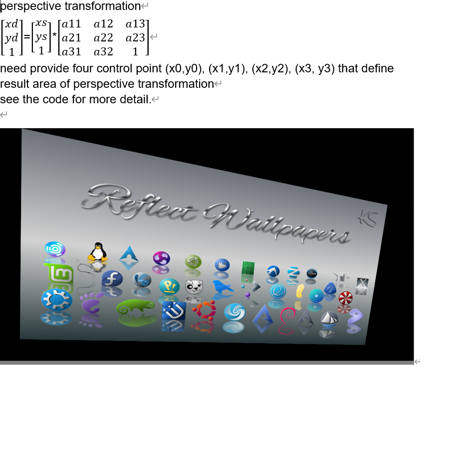

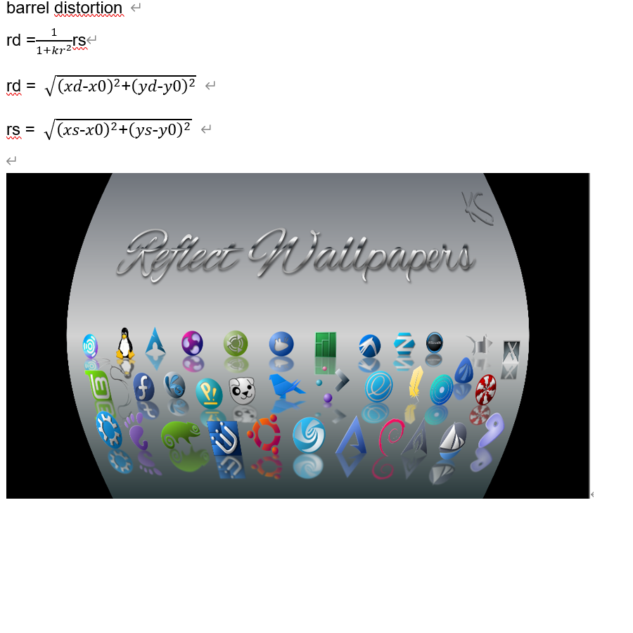

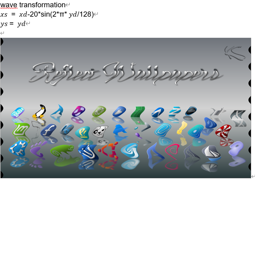

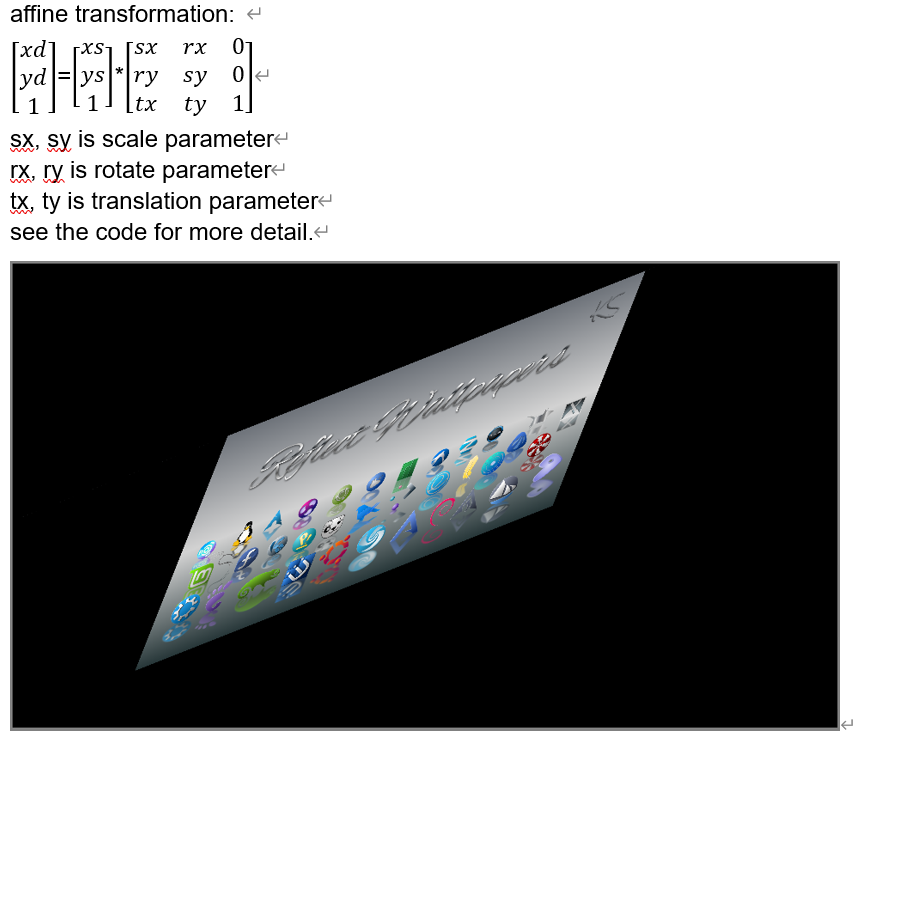

imx8-ov5640-dpu-warp-render.c is a sample code which show how to call g2d lib to image warp, need open the G2D_WARP flag.

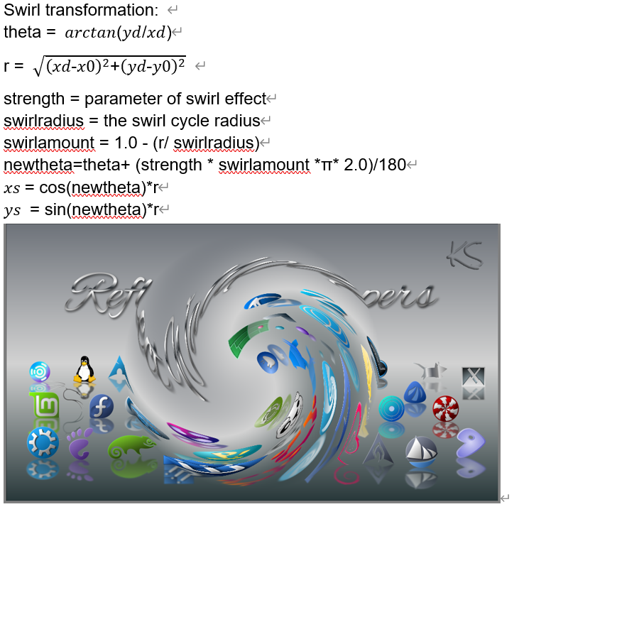

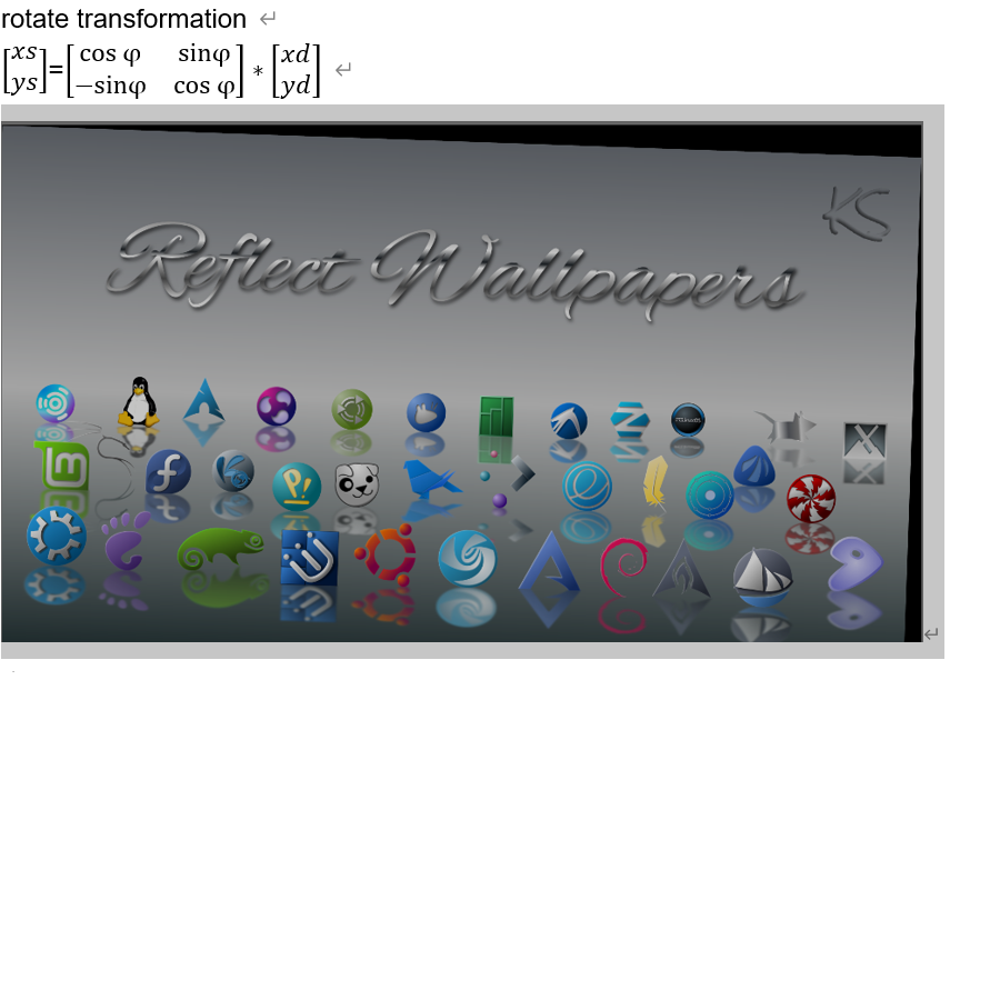

And this code contain some example calculate the coordinate buffer of rotate, swirl, barrel distortion, affine transformation, perspective transformation, wave transformation.

        -t <warptype>   set 0 neutual 1 rotate 2 swirl 3 divisionmodel 4 affine 5 perpsptive 6 wave

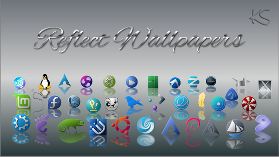

 3.Example
original image:
