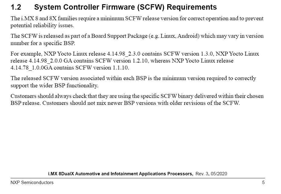

Please pay attention to sw package revisions as they should fit to each other:
refer to Table 3. BSP and Multimedia standard packages attached Release Notes
and sect.1.2 System Controller Firmware (SCFW) Requirements
i.MX 8QuadXPlus and 8DualXPlus Automotive and Infotainment Applications Processors
All documentation (Release Notes, Linux Manual) for each software release can be found on link:
i.MX Software and Development Tools | NXP
