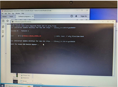

We are experiencing issues during startup during training of the LPDDR4 on some of our IMX8QXP-based products.
The products reboot a few times during startup (found by measuring the reset pin), before being able to continue to the SCFW/UBoot.
The problem also manifests itself when using the MFG/UUU tool.
Multiple reboots/attempts are needed to get the UUU to go past an initial LIBUSB IO error at 18%.

This week we removed the function pmic_update_timing from the board.c file in the SCFW. And we found that the UUU tool no longer gives the error after the second try. Perhaps the issue is related to power-up sequence?

r_veens
Hi Ritesh,
The issue is not resolved, the error still occurs. We would like to know why the error occurs.
Could you please answer the questions in the original post, thanks.
