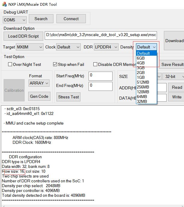

        I have a qustion about use 8G LPDDR4 instead of 3G lpddr4 on IM8MQ.
       Firstly download the laster ddr tools with mscale_ddr_tool _v3.20 and MX8M_LPDDR4_RPA_v29.xlsx.

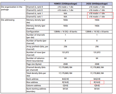

       Then open the DDR datasheet, I can see the below infomation
       row aaddress is [16:0]

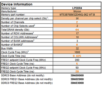

       so I modify the RPA file
        copy DDR strees test file to xxxx.ds and run the mscale DDR tool. the result is raw 16, something wrong?   Does the tool can support to 8G?
    and how the modify the uboot code about it.

Hi Coin
unfortunately lpddr4 devices with 17-row addresses are not supported by i.MX8MQ.
