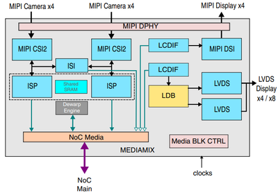

I wanna add spread spectrum for my IMX8MP LVDS screen signal.
I find that the feature is available for 8QuadMax and i.MX 8QuadXPlus Display but not for i.MX 8MP.
Do you know when this will be available or there is already a patch to add it ?
Thanks.

On our i.MX8MP EVK the enablement of Spread Spectrum Clocking is via software.
We don't have any code example to apply the required changes.
Here is a description of Spread Spectrum enablement for LVDS interface.
The LVDS interface doesn't have an integrated PLL such as MIPI or USB interface, therefore, LDB (LVDS Display Bridge) module uses VIDEO_PLL1 as root clock and VIDEO_PLL1 support SSCG (Spread Spectrum Clock Generator).
Here is a block diagram of LVDS interface on iMX8M Plus.
To enable the Spread Spectrum Clocking for LVDS interface you will need to write on VIDEO_PLL1 control register.
You will need to set SSCG_EN and the other parameters (MFR, MRR, SEL_PF, SEL_PF) with U-Boot.
For a proper setting up, please have a look to the section 5.1.5.4.4 SSCG and Fractional PLLs on the i.MX8MP Reference Manual.

clemntnxp
It works, thank you.
