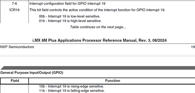

danielchen
I would suggest you check the GPIO4_ICR2 register,  to get the real trigger type configured.
Bit 6-7 correspond to pin 19.
If you are not using DTS,  ensure you explicitly set the IRQ type in your driver before calling request_irq( );
irq_set_irq_type(irqNumber, IRQ_TYPE_EDGE_FALLING);
