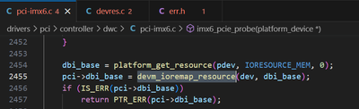

[ 2.611260] imx6q-pcie 33800000.pcie_ep: invalid resource
[ 2.611263] imx6q-pcie 33800000.pcie_ep: iATU unroll: enabled

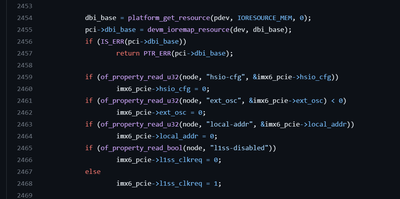

Mysteriously the command register is cleared. Since the PCI_COMMAND MEMORY access bit is cleared,
any reads from the memory mapped BAR0 space return 0xFFs.
I've traced the host PC kernel and verified that nothing is calling the pci_bus_write_config_(byte|word|dword) functions after exiting the driver probe function.
On the device I can check the HSIO registers to see the PCIe error and status registers:
After the driver module load:
# ./hsio
00: 00000033
04: 00002023 PLL_LOCK=1 PCIE_CTRL_PM_DSTATE=0 SMLH_LTSSM_STATE=0x11 PM_EN_CORE_CLK=1
08: 1fccc80c
0c: 80021000
10: 00000000
14: 00000000
18: 00000000
1c: 00000000
20: 00000000
24: 00000000
A few seconds later:
# ./hsio
00: 00000033
04: 0000201b PLL_LOCK=1 PCIE_CTRL_PM_DSTATE=0 SMLH_LTSSM_STATE=0x0d PM_EN_CORE_CLK=1
08: 1fccc80c
0c: 80021000
10: 00000000
14: 00000000
18: 00000000
1c: 00000000
20: 00000000
24: 00000000
Again immediately after that:
# ./hsio
00: 00000033
04: 00003023 PLL_LOCK=1 PCIE_CTRL_PM_DSTATE=4 SMLH_LTSSM_STATE=0x11 PM_EN_CORE_CLK=1
08: 1fccc80c
0c: 80021000
10: 00000003 LDD=1 LUD=1
14: 00000000
18: 00000000
1c: 00000000
20: 00000000
24: 00000000
The HSIO BLK_CTRL register PCIE controller status (GPR_REG1 0x04) changes when the problem occurs:  The SMLH_LTSSM_STATE goes from 0x11 to 0x0d and back to 0x11. According to pcie-designware.h, the PORT_LOGIC_LTSSM_STATE_L0 is 0x11, and PORT_LOGIC_LTSSM_STATE_L2 is 0x15. Not sure what 0x0d could be.
The IMX8MPRM says merely "SMLH_LTSSM_STATE: PCIE link state".
The PCIE_CTRL_PM_DSTATE goes from 0 to 4, and stays there.
The IMX8MPRM says merely "PCIE_CTRL_PM_DSTATE: PCIE ctrl's pm dstate".
The register PCIE PME message and error detect register (GPR_REG4 0x10) also shows that the Link also appears to have gone down and back up, being both Link Down Detected (LDD) and Link Up Detected (LUD) are set.
Can anyone tell me what is going on here? What could be triggering the linkdown/linkup? What does SMLH_LTSSM_STATE=0x0d and PCIE_CTRL_PM_DSTATE=4 mean?

lm_8086
I have added log message if resource (res) is null, and got the log line on dmesg:
[ 2.539342] imx6q-pcie 33800000.pcie_ep: supply epdev_on not found, using dummy regulator
[ 2.542931] imx-cpufreq-dt imx-cpufreq-dt: cpu speed grade 2 mkt segment 2 supported-hw 0x4 0x4
[ 2.551247] imx6q-pcie 33800000.pcie_ep: PLL REF_CLK is used!.
[ 2.563955] imx-drm 32c00000.bus:display-subsystem: bound imx-lcdif-crtc.0 (ops 0xffffffc011013c08)
[ 2.566354] imx6q-pcie 33800000.pcie_ep: PCIe PLL locked after 20 us.
[ 2.574948] imx_sec_dsim_drv 32e10000.mipi_dsi: version number is 0x1060200
[ 2.581163] imx6q-pcie 33800000.pcie_ep: res is null!
[ 2.588034] imx_sec_dsim_drv 32e10000.mipi_dsi: Failed to attach bridge: 32e10000.mipi_dsi
[ 2.593057] imx6q-pcie 33800000.pcie_ep: invalid resource
and it relates to pci-imx6.c in dwc:
I did not found IS_ERR macro definition (maybe it is a function?) but found in Documentation.
It seems it returns TRUE if pci->dbi_base is above ((unsigned long)(-1000)) so if it is NULL (0) then it will not return with PTR_ERROR.

pete_sensoray
IS_ERR lives in "include/linux/err.h" as an inline function, which calls the macro IS_ERR_VALUE().  It uses a different value than the documentation (-1000) but uses the same scheme.
 * Kernel pointers have redundant information, so we can use a
 * scheme where we can return either an error code or a normal
 * pointer with the same return value.
 * This should be a per-architecture thing, to allow different
 * error and pointer decisions.
#define MAX_ERRNO       4095
#ifndef __ASSEMBLY__
#define IS_ERR_VALUE(x) unlikely((unsigned long)(void *)(x) >= (unsigned long)-MAX_ERRNO)
<snip>
static inline bool __must_check IS_ERR(__force const void *ptr)
        return IS_ERR_VALUE((unsigned long)ptr);
What are you using for your the PCI config registers? Please let me know if you find a solution to the D3 state.  I think that is what is preventing me from using the IMX8MP endpoint in my AMD system.

lm_8086
Actually this fragment will return in following fragment:
so pcie_probe will not be fully executed ((unsigned long) -EINVAL >= (unsigned long) -MAX_ERRNO) since MAX_ERRNO > EINVAL.
19,500 Views
pete_sensoray
Are you using the correct DTS file?  On mine, it includes the arch/arm64/boot/dts/freescale/imx8mp.dtsi (yours is probably using imx8mm.dtsi) which has this node:
		pcie_ep: pcie_ep@33800000 {
			compatible = "fsl,imx8mp-pcie-ep";
			reg = <0x33800000 0x000400000>, <0x18000000 0x08000000>;
			reg-names = "regs", "addr_space";
This is what gets read for platform_get_resource(pdev, IORESOURCE_MEM, 0) and the dbi_base->start and dbi_base->end correspond to the first pair on the "reg = " line.  You could print the values using
pr_info("dbi_base=%p start=%llx end=%llx\n", dbi_base, dbi_base ? dbi_base->start : 0, dbi_base ? dbi_base->end : 0);
between the platform_get_resource and devm_ioremap_resource calls.

I have added following loggers to pci-imx6.c:
    u32 i;
    dev_info(dev, "Num resources %d\n", pdev->num_resources);
    for (i = 0; i < pdev->num_resources; i++) {
        struct resource *r = &pdev->resource[i];
        dev_info(dev, "Resource type = %llx\n", resource_type(r));
        dev_info(dev, "Resource ptr = %p start=%llx end=%llx\n", r, r->start, r->end);
    dbi_base = platform_get_resource(pdev, IORESOURCE_MEM, 0);
    pci->dbi_base = devm_ioremap_resource(dev, dbi_base);
    if (IS_ERR(pci->dbi_base))
        return PTR_ERR(pci->dbi_base);
[ 2.541013] SoC: i.MX8MM revision 1.0
[ 2.541360] imx6q-pcie 33800000.pcie_ep: Num resources 3
[ 2.544996] imx-cpufreq-dt imx-cpufreq-dt: cpu speed grade 2 mkt segment 2 supported-hw 0x4 0x4
[ 2.550022] imx6q-pcie 33800000.pcie_ep: Resource type = 200
[ 2.550030] imx6q-pcie 33800000.pcie_ep: Resource ptr = 000000008bb02703 start=33800000 end=33bfffff
[ 2.563663] imx-drm 32c00000.bus:display-subsystem: bound imx-lcdif-crtc.0 (ops 0xffffffc011060f68)
[ 2.564427] imx6q-pcie 33800000.pcie_ep: Resource type = 200
[ 2.573951] imx_sec_dsim_drv 32e10000.mipi_dsi: version number is 0x1060200
[ 2.582630] imx6q-pcie 33800000.pcie_ep: Resource ptr = 00000000ad1c6142 start=18000000 end=1fffffff
[ 2.588355] imx_sec_dsim_drv 32e10000.mipi_dsi: Failed to attach bridge: 32e10000.mipi_dsi
[ 2.595286] imx6q-pcie 33800000.pcie_ep: Resource type = 400
[ 2.604414] imx_sec_dsim_drv 32e10000.mipi_dsi: failed to bind sec dsim bridge: -517
[ 2.608514] pps pps0: new PPS source ptp0
[ 2.612727] imx6q-pcie 33800000.pcie_ep: Resource ptr = 00000000275e800e start=3e end=3e
[ 2.638664] imx6q-pcie 33800000.pcie_ep: supply epdev_on not found, using dummy regulator
[ 2.639138] fec 30be0000.ethernet: Invalid MAC address: 00:00:00:00:00:00
[ 2.647264] imx6q-pcie 33800000.pcie_ep: PLL REF_CLK is used!.
[ 2.653715] fec 30be0000.ethernet: Using random MAC address: ee:e9:b9:10:f9:7d
[ 2.660439] imx6q-pcie 33800000.pcie_ep: PCIe PLL locked after 20 us.
[ 2.667963] libphy: fec_enet_mii_bus: probed
[ 2.673375] imx6q-pcie 33800000.pcie_ep: invalid resource
Now I will add your proposed logger, but it seems that invalid resource is coming out of probe function (I assume it is in deassert level).
