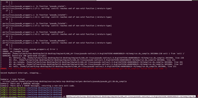

bitbake imx-image-desktop -c populate_sdk gets an error when it compiles to pseudo. When compiling the filesystem, pseudo-native compiles without errors. I don't know what the problem is.

I'm sorry, but it still fails after I try. I want to ask, my environment is Ubuntu18.04, is it caused by the environment problem

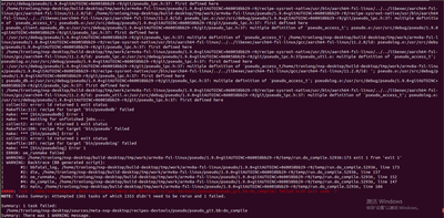

ace12
Sorry, I tried Ubuntu22.04, but it still gave an error, and I have updated the environment according to all the commands you gave. Below is the log of the error record
