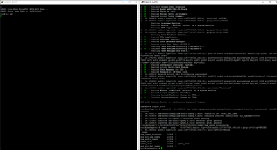

I have tested the imx8mp evk for cortex m7 communications, and I found that after loading the .bin module in u-boot, take imx8mp_m7_TCM_hello_world.bin as an example, the hello world could show up successfully, and I tried to boot the kernel continue, and it occurred error interrupt.
Here is the full boot log from u-boot to kernel error interrupt

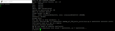

u-boot=> fatload mmc 1:1 0x48000000 imx8mp_m7_TCM_hello_world.bin;cp.b 0x48000000 0x7e0000 20000;
8500 bytes read in 1 ms (8.1 MiB/s)
u-boot=> bootaux 0x7e0000
## No elf image at address 0x007e0000
## Starting auxiliary core stack = 0x20020000, pc = 0x0000048D...

AlanWen
After running the steps, I boot up the kernel and it returned this message below and stock at here.
Starting kernel ...
[    0.000000] Booting Linux on physical CPU 0x0000000000 [0x410fd034]

8,846 Views
joanxie
yes I reproduced this on my board, confirmed that hello world demo doesn't include publish resource table, so pls change another demo, I tried below succesfully
If you choose to use remoteproc to start the remote core directly, execute run prepare_mcore in U-Boot before starting the Linux OS.
8,803 Views
AlanWen
I tried the approach but it still failed.

Currently, I tested the kirkston, mickledore, scrathgap kernel version, and there are some difference between these versions.
1. kirkston
It could run the pingpong demo code as well without kernel crashed by first command
setenv fdtfile imx8mp-evk-rpmsg.dtb
setenv m7_image imx8mp_m7_TCM_rpmsg_lite_pingpong_rtos_linux_remote.bin
setenv m7_loadaddr 0x7e0000
setenv m7_copyaddr 0x80000000
setenv m7_loadimage "fatload mmc '${mmcdev}':'${mmcpart}' '${m7_copyaddr}' '${m7_image}'; cp.b '${m7_copyaddr}' '${m7_loadaddr}' 0x20000"
setenv m7_run_image "run m7_loadimage; dcache flush; bootaux '${m7_loadaddr}'"
run m7_run_image
boot
 2. mickledore & scrathgap
Can boot up by first commands but have no response while insmod command probe the demo driver both in A53 debug console and M7 debug console.
