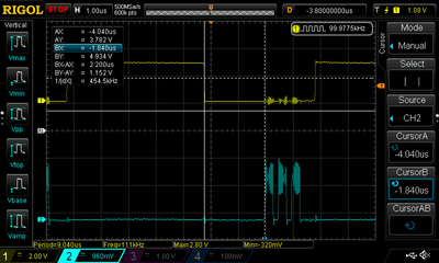

I am using the i.MX8MP SoC and have configured the SPI frequency to 25 MHz and 1 am writing 24-bit data. However, I am observing an extended CS (Chip Select) low time of approximately 2.2 µs before the SCLK (Serial Clock) starts, as seen in the captured image.
What steps can I take to reduce the CS low time before the SCLK begins? Any guidance or suggestions

Hi @asdaposdi,
I hope you are doing well.
Could you please share the waveform, and device tree node for further debugging?
Please mention how you are testing it in userspace
The delay between two SPI bursts can be caused by dma limitations.
It seems to be expected behavior.
Yes, Moving SPI interfacing to the Cortex-M core can show improvements.
