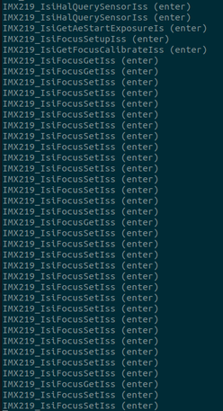

Now the problem begins. We use ./vvext 2 command to control camera features like AutoFocus. When I enter the proper inputs to vvext API, for example, enabling AF, setting mode to manual and setting AF Length to 100(other values are also tested) nothing hapens.
To analyze the problem, we have placed a debug lines to the IMX219_IsiFocusSetIss function, in the imx219.c code in the isp-imx repo. We have approved that when we apply vvext api command, isp-media-server enters focus functions. However these function are all empty and only contains TRACE log lines.
Screenshot from 2024-08-31 22-20-34.pngScreenshot from 2024-08-31 22-20-34.png
This topic also claims that these functions are empty. We have test isp-imx versions from 18 to 24 and all are the same.
To sum up, we can not run manual focus or auto focus vv_ext controls via API. Can you guide us to solve this problem?
