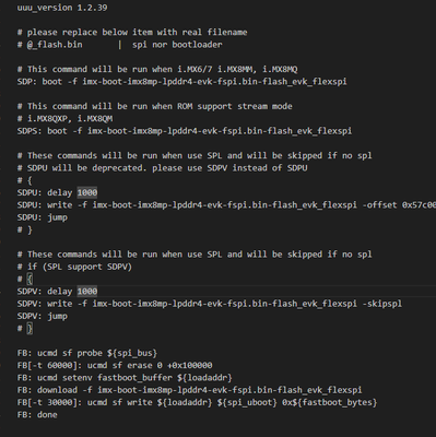

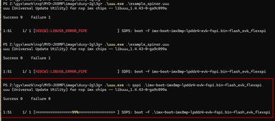

gongyaxuan
I downloaded the jx8mp_evk_6.1.55 image and generated the above method failed to burn write boot
uuu-b qspi boot_loader, burned to 99% stuck
uuu The configuration is as follows
3,065 Views
gongyaxuan
Does anyone answer this question? I wonder if IMX8MP supports qspi startup at most, and if it does, how to burn the mirror and how to operate it. thank you
