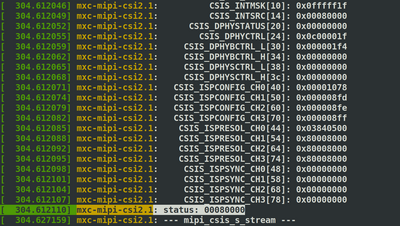

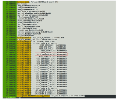

Through the kernel dmesg CMD, output the mipi csi register:

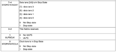

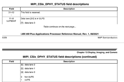

As shown in the figure above, the register value of CSIS_DPHYSTATUS[20] is 0Xb1, which should be 0Xf1 normally, indicating that all lines enter the stop state. The register description is as follows:

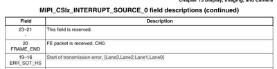

after update the firmware of LT6911C,we can see the interrupt trigger of the MIPI-CSI,But a new error occurs as below:
We check the field descriptions, status = 0x80000 means line3 fails to start transmission, 19~16 bits of the following registers:
The MIPI host reports Start of transmission error, [Lane3,Lane2,Lane1,Lane0]
10,290 Views
