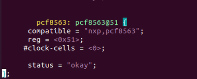

5454ty
HI,
   My dts is as follows:
5,722 Views
Chavira
Hi @5454ty!
I recommend to use the next configuration:
pcf8563: pcf8563@51 {
      compatible = "nxp,pcf8563";
      reg = <0x51>;
     #clock-cells = <0>;
      status = "okay";
Best Regards!
Chavira
5,590 Views
5454ty
HI,
   I used the above configuration
 But ,it still reported error when the system is bootup
rtc-pcf8563 2-0051: registered as rtc0
rtc-pcf8563 2-0051: hctosys: unable to read the hardware clock
