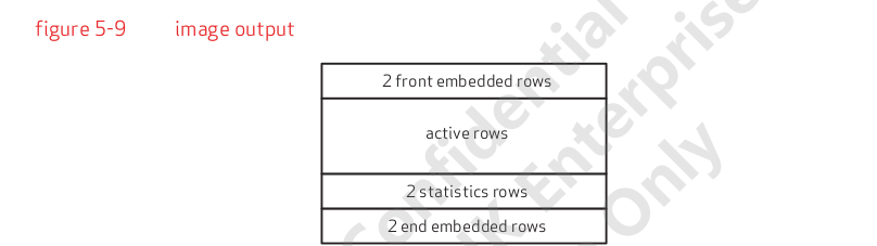

I am porting a new sensor, which output image format as RAW + metadata. Please see the image.
Can IMX8MP CSI receive such image format?

joanxie
imx8mp mipi csi doesn't support embedded data
