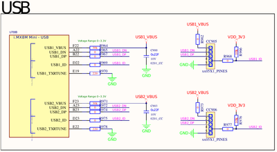

I have a custom imx8mm board with a 512MB DDR4 (K4A4G165WE-BCTD) and a MMC (THGBMNG5D1LBAIL).
I'm trying to program the uboot using UUU software, but stop with that message:
U-Boot SPL 2020.04-00001-g62a81128c0-dirty (Feb 07 2023 - 11:01:55 +0000)
DDRINFO: start DRAM init
DDRINFO: DRAM rate 2400MTS
DDRINFO:ddrphy calibration done
DDRINFO: ddrmix config done
Normal Boot
Trying to boot from USB SDP
g_dnl_register: failed!, error: -12
SDP dnl register failed: -12
SPL: failed to boot from all boot devices
### ERROR ### Please RESET the board ###
I saw that in ci_udc_probe function (in ci_udc.c file), failed in memalign
/* The QH list must be aligned to 4096 bytes. */
controller.epts = memalign(eplist_align, eplist_sz);
if (!controller.epts){
return -ENOMEM;
In my custom board I didn't have one USB type C, so I follow that topic:
https://community.nxp.com/t5/i-MX-Processors-Knowledge-Base/i-MX8MM-i-MX8MQ-USB2-0-Design-Without-US...
What can be wrong to failed?
Thanks in advance.

FYI, I found the raison why on some board, I got this failure during uuu download.
Verify the state of USB1_ID (pinD22). In my board with issues, this signal was grounded or not floating.
Regards.

Hi Aldo,
In the schematic, at the beginning I have the usb1 and usb2 configurated in that way.
I don't have any usb connector, but like I have, in another's projects it's work very well.
With that configuration, using UUU tool, In the terminal, the boot stops here:

Then, I change the hardware, inserting the MIC2026, using only the A input/flag/output, and the result is the same.
As you can see, I put a printf ("CRCN controller.epts is null") if the result of the memalign is null.
Another test that I make, was configure  USBNC_n_CTRL2 register (0x32E40204), to change DIG_ID_SEL to 1 (0xDF100000). Result is the same..
Why the boot stops here, in memalign? For me is strange that the USB part of the schematic is bad, if the Uboot SPL start run... Can be another problem regarding DDR, MMC, etc???

AldoG
I see that you are not using UBS_OTG_ID pin in your schematic even though it is defined as otg in your device tree and in your schematic, this could be causing the issue, please try by setting one of the 2 modes in device tree by using:
dr_mode = "peripheral";
