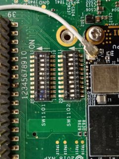

Previously i was able to flash the imx8mm evk with new image in emmc,
Observation: The previously loaded image boots properly, But  after changing the switch to flashing mode i am not able to program the new image now. What may be the issue.
Santhosh Kumar S
2,928 Views
AldoG
Could you please share more information, for example how are you trying to flash the eMMC?
I suppose that you're trying to flash Linux, could you share the version as well?
Also, I couldn't see that well the dip switch value from the image you have shared, if possible write the value of the SW1101 & SW1102.

santhosh2
santhosh: Yes Iam trying to flash into eMMC via serial port (Debug)
Santhosh: Yes i am trying to flash linux and version is 4.14.78-imx_4.14.78_1.0.0_ga+g94da7bd
I was using below switch position for flashing the image, but from few days i am not able to flash the new image
 12345678910
sw1ONOFFONOFFONONOFFOFFOFFON
 12345678910
sw2OFFOFFOFFONOFFONOFFONOFFOFF
Please help

AldoG
Thank you for sharing more information, everything looks correct, the only thing that I would like you to share more in detail is how are you flashing the image.

santhosh2
I am using the uuu tool to flash, but the issue i am facing is, its is not detecting the download USB type C port. Normally when you put in program mode it should detect the NXP semiconductor but now the Port is not getting detected,  I am getting the below massage when i do dmesg command in terminal.
What might be the issue
