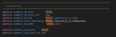

recently I was developing an application for imx8mm cortex-m4 and a GPIO interrupt was needed. I haven't found any examples available that show how to properly configure the GPIO interrupt.
Do you have imx8MM M4 MCU GPIO input interrupt example code?

I know, in SDK is not an GPIO input interrupt example.
I made a little program to use an interrupt in GPIO5_12 (I connected a push button) and I used the GPIO5_11 to toggle a LED in each interrupt.
Keep in mind the interrupts in SDK has a "number of IRQ (GPIOn_Combined_0_15_IRQn or GPIOn_Combined_16_31_IRQn)" and for an IRQHandler.
There you can see the simple definition of GPIO5_IO12 pin and the GPIO5_Combined_0_15_IRQn and  GPIO5_Combined_0_15_IRQHandler, this handler is only a "pointer" to our IRQHandler function:
If you require more information about of IRQs you can see the Reference Manual Table 7-1 ARM Domain Interrupt Summary.
That is the reason why we need GPIO5_Combined_0_15_IRQn.
Any way, I will attach the gpio_led_output.c, there is the example of using interrupt in GPIO5_IO12 and toggle led in GPIO5_IO11.

In this case, I cloned the gpio_led_output example that is in folder /driver_examples/gpio/gpio_led_output and then I modified the code there.
You can start your own project from a project template that is include in the SDK folder but you need to do several modifications.
Cloning the example you will be able to compile in the same way that you compile an example but with your own code.

Yes this helped me a lot. Your example worked perfectly. But it's important to mention that when you're working on a system that runs Linux on the main processor and you try use the GPIO interrupts on the M4 core you can face some issues and conflicts.
