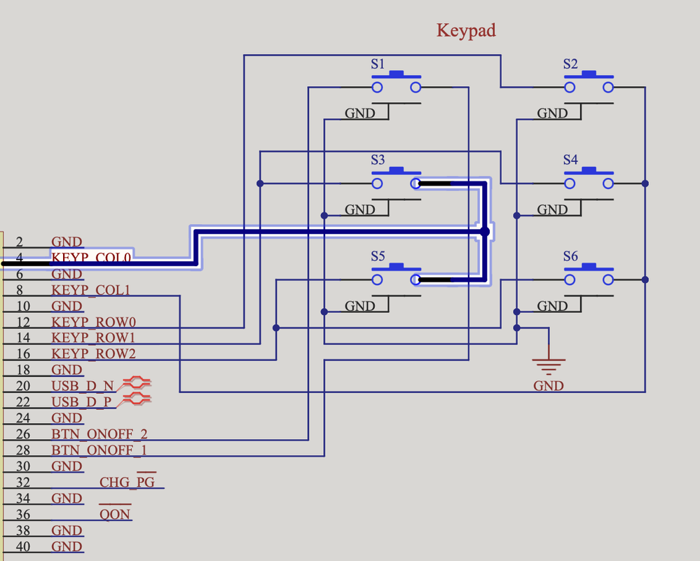

I've been following this guide: https://www.emcraft.com/som/vf6/controlling-gpio-from-linux
trying to add a keypad to my imx8mm based board.
I added this to my device tree:
    gpio-keys {
		compatible = "gpio-keys";
		pinctrl-names = "default";
		pinctrl-0 = <&pinctrl_gpio_keys>;
		col0_btn {
			label = "COL0_BTN";
			gpios = <&gpio1 5 GPIO_ACTIVE_LOW>;
			gpio-key,wakeup;
			linux,code = <BTN_0>;
&iomuxc {
		pinctrl_gpio_keys: keys0grp {
			fsl,pins = <
				MX8MM_IOMUXC_GPIO1_IO05_GPIO1_IO5		0x1d6 /* KEY_C0 */

However, no push of the button is ever registered. I'm wondering if somehow the mapping between
gpios = <&gpio1 5 GPIO_ACTIVE_LOW> and MX8MM_IOMUXC_GPIO1_IO05_GPIO1_IO5 is incorrect and is something other than what seems obvious?

J_W
Hi Jorge,
Here is the schematic for the keypad. It goes to a connector and then on to another custom board which in turn connects to the imx8. We've used this same keypad in an IMX6 based application.
5,500件の閲覧回数
J_W
I switched to open drain instead of active low and I get response from COL_0 now though not the buttons themselves.
I suppose I am missing something in how to implement a matrix keyboard. I did some googling but did not manage to find anything useful for the imx8, a lot of stuff just for the imx6 which has a driver for it. Do you have any examples at NXP?
