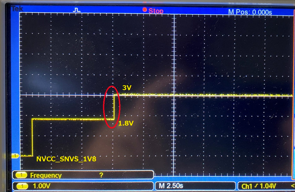

we are using BSP L4.19.35 but appears NVCC_SNVS_1V8 (PMIC LDO1) phenomenon changed from 1V8 -> 3V
Waveform:
+ When trying 3 BSP versions on IMX8MM EVK board, we have the following results
- BSP L4.14.78 → LDO1 unchanged
- BSP L4.19.35 → LDO1 Has been changed
-  BSP L5.4.24 → LDO1 unchanged
+ Check register set PMIC LDO1_ 0x18 corresponding to get the results
Command: i2cget -f -y 0 0x4b 0x18
- L4.14.78 -> result = 0x62 (1.8V)
- L4.19.35 -> result = 0x40 (3V)
- L5.4.24 -> result = 0x62 (1.8V)
* See the attached Log file and PMIC_LDO1_reg.png Image

Hi Huy
 there are different patches for this issue, please appy the correct patch on the right release branch:
  1). imx_4.14.98_2.3.0:
     0001-MLK-23275-1-ARM64-dts-freescale-fsl-imx8mm-evk-corre.patch
     0002-MLK-23275-2-ARM64-dts-freescale-fsl-imx8mn-ddr4-evk-.patch
     0003-MLK-23275-3-regulator-bd71837-correct-ldo1-ldo2-grou.patch
  2). imx_4.19.35_1.1.0:
     0003-MLK-23846-ARM64-dts-freescale-fsl-imx8mn-ddr4-evk-co.patch
  3). imx_5.4.3_2.0.0:
     0002-MLK-23275-2-ARM64-dts-freescale-imx8mn-ddr4-evk-corr.patch
     0003-MLK-23844-1-ARM64-dts-freescale-imx8mn-ddr4-evk-clea.patch
     0004-MLK-23844-2-ARM64-dts-freescale-imx8mm-correct-VDDAR.patch
make search on link
https://source.codeaurora.org/external/imx/linux-imx/log/?h=imx_5.4.3_2.0.0&qt=grep&q=MLK-23275
