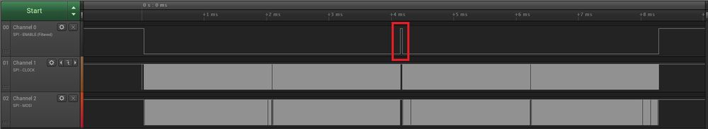

I have an ECSPI problem on the IMX8MM.
I try to send data with a length of 1024Byte, but the CS status changes at 512Byte.
I know ECSPI has a maximum length of 512 Byte per transmission, is there a way to make the CS not change state during transmission?
I must ensure that the slave receives the full data being sent in each CS cycle.

  512 bytes is the maximum length. You can use a GPIO pin instead of ECSPI CS (SS)
to transfer more data.

I know this solution, but using it will make the data transfer time longer because the manual control of CS-GPIO will have a delay.
I have a functional requirement to send 8MB of data, so I have to cut multiple packets to send because the slave receives up to 16KB of data in a single transaction, which makes the transfer time even longer.
I would like to know other solutions to reduce the delay time caused by manual control by setting spi dma or register.
