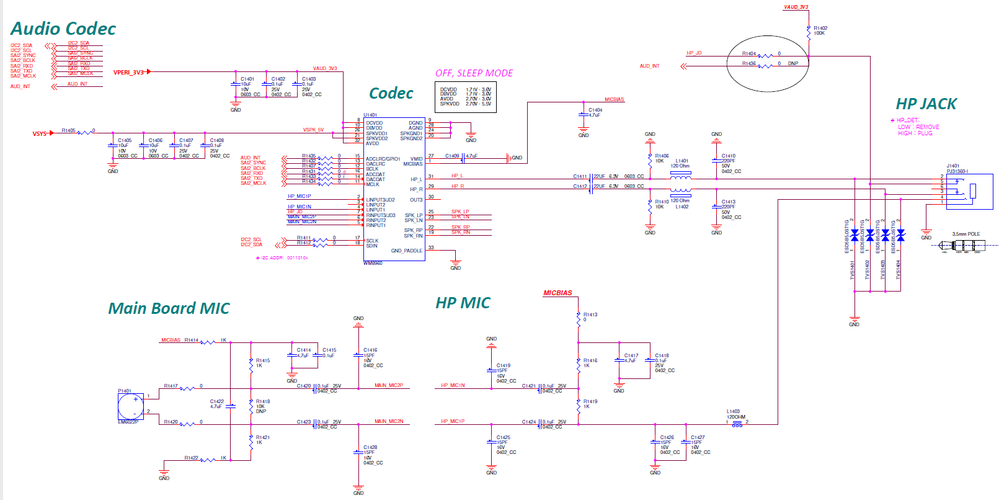

Is anyone interfaced analog microphone (from TDK/Knowles) with i.MX8M mini/Nano evaluation/custom board? If yes, please share schematic of microphone section.

You can refer to the MCIMX6ULL-EVK Design, use the WM8960, use the SAI interface. You need to modify less in solftware.
Hope this can do help for you.

Thank You b45499
It is helpful. Also looking for direct interfacing of Analog microphone.
