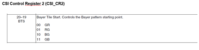

   Is there any difference about BGGR and RGGB format because of the patch configured the BGGR format. Our camera driver is configured to rggb can you please add related to the color format patch
14,085 Views
joanxie
if you don't use the same bayer pattern, you need change this register

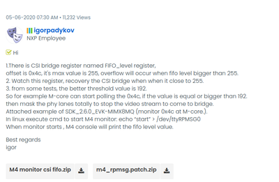

sorry, I take annual leave this week, since I couldn't reproduce this issue and other customer can set raw10 on im8mm without any fifo overflow issue, I only can give you some suggestions
1) you should already notice this link, you can try to change the register as the the internal team said
https://community.nxp.com/t5/i-MX-Processors/RX-fifo-overflow-on-MIPI-CSI2-i-MX8MQ/m-p/1087696
2) try to change the data lane to 2

joanxie
imx8mm and imx8mq uses the same csi ip, you can find they use the same csi driver,  try to change the registers as link mentions, no finding other patches for this issue
13,709 Views

1)I'm not saying this patch, I mean you can change the csi phy register when you get the wrong value from CSICR19, if you get overflow error, try the stpes: 1)Disable the CSI, 2)Clear the RX FIFO,3) Reflash the DMA controller, 4) then enable CSI
2)try to change the cr2 register under function "mx6s_configure_csi", for example
csi_dev->fmt->pixelformat == BIT_MIPI_DATA_FORMAT_RAW10) {
cr2 |= (0x2 << 19);
csi_write(csi_dev, cr2, CSI_CSICR2);}
this is just an example, pls change it according to your camera

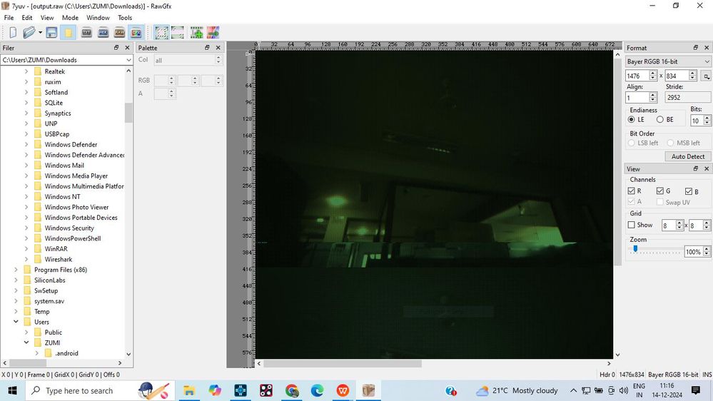

santhana_kumar
We are already applied the patch and we can able to capture the image
For RAW10 image :
If the input data from the sensor is 10-bit/pixel or 16-bit/pixel format, the IMAGE_WIDTH should be a multiple of 4 pixels.
12,714 Views
santhana_kumar
Joan,
Disabled the CR18 bits(BASEADDR_SWITCH_EN & BASEADDR_SWITCH_SEL) and now we are able to capture the image. please see the attached picture
Can you please explain detail why if we can disable the bit and we can able to capture the image?
12,503 Views
joanxie
in fact, you should get detailed register description in the reference manual, BASEADDR_SWITCH_EN controls the buffer start address switch when one frame image data is done. When this bit is set to 1'b0, the start address of frame buffer will not change, and the image data is store in one buffer so If set BASEADDR_SWITCH_EN = 0, not care BASEADDR_SWITCH_SEL. The frame buffer only used one and the data is refresh by the embedded DMA.
12,495 Views
