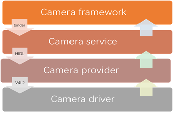

while on I.MX camera HAL, the camera subsystem can be divided into several parts:
  • Camera framework:  frameworks\av\camera
  • Camera service:    frameworks\av\services\camera\libcameraservice\
  • Camera provider:
    1. hardware/interfaces/camera/provider/
    2. hardware/google/camera/common/hal/hidl_service/
              hidl_service dlopen the camera HAL3.
  • Camera HAL3:   vendor\nxp-opensource\imx\camera\
  • Camera driver:   vendor/nxp-opensource/kernel_imx/drivers/media/i2c

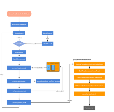

 It's callstack can be list as follow:
TonyLiao_suzhou_1-1669960725413.pngTonyLiao_suzhou_1-1669960725413.pngTonyLiao_suzhou_2-1669960738653.pngTonyLiao_suzhou_2-1669960738653.png

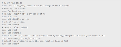

 The default image for i.MX 8M Plus EVK supports basler + basler and the cameras can work after the image is flashed and boot up, it’s camera with ISP, but we need ISI to process raw. You should refer to Android_User’s_Guide.pdf, you need find the correct version, as Android12_2.0.0 is different with Android12_1.0.0. To make cameras work with Non-default images, execute the following additional commands:
Only OV5640 (CSI1) on host:

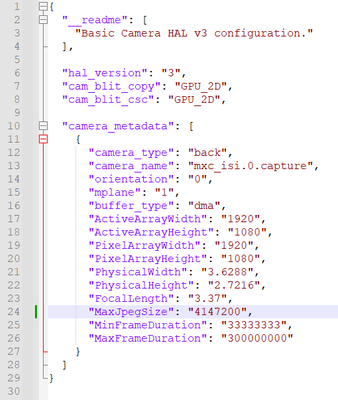

As we use OV2775 which support 1920*1080, unpacked raw12, the json file:

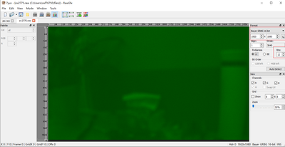

4.2 Tool
We use 7yuv tool to check the raw12 format, which is captured by applicable or dump by HAL, you need set the parameter on the right side:
ImageJ tool also can be used to review raw format.
