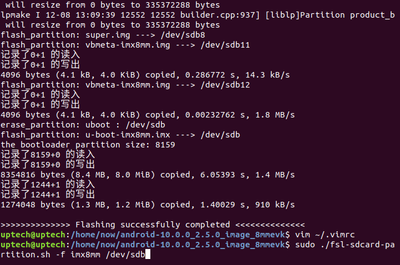

hello,I use imx8mm android10,I only modified the SD card pins,uboot-imx/arch/arm/dts/imx8mm-evk.dts:
  • 369 &usdhc2 {
  • 370     pinctrl-names = "default", "state_100mhz", "state_200mhz";
  • 371     pinctrl-0 = <&pinctrl_usdhc2>, <&pinctrl_usdhc2_gpio>;
  • 372     pinctrl-1 = <&pinctrl_usdhc2_100mhz>, <&pinctrl_usdhc2_gpio>;
  • 373     pinctrl-2 = <&pinctrl_usdhc2_200mhz>, <&pinctrl_usdhc2_gpio>;
  • 374     //cd-gpios = <&gpio1 15 GPIO_ACTIVE_LOW>;
  • 375     cd-gpios = <&gpio2 12 GPIO_ACTIVE_LOW>;//add cjf
  • 376     bus-width = <4>;
  • 377     vmmc-supply = <&reg_usdhc2_vmmc>;
  • 378     status = "okay";
  • 379 };After compiling uboot, burn the image to the SD card:sudo ./fsl-sdcard-partition.sh -f imx8mm /dev/sdb
     uboot Boot failure:

    avb_slot_verify.c:772: ERROR: vbmeta_a: Error loading vbmeta data.
    verify FAIL, state: LOCK
  • What should I do?
7,265 Views
Rita_Wang
The controller connected to the SDcard slot is set to work with Wi-Fi expansion card in Android10.0.0_2.5.0 demo image, it does not support to access SDcard.
so basically, if the dtbo image support Wi-Fi expansion card, then the images cannot boot up from SD card.
