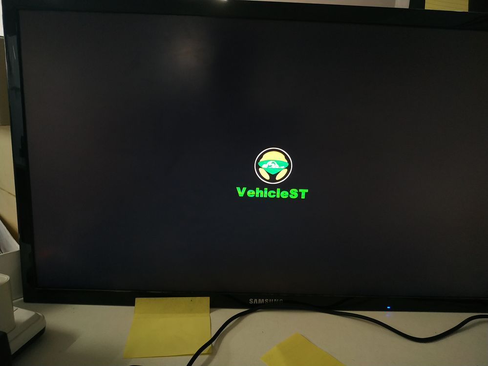

Iam building android 7.1.2 SabreAuto BSP for our board ,successfully  flashed images into 16Gb microSD card using script fsl-sd-card-partition.shwhich is attached below.But when we powered on our board it boots up showing bootanimation and it get stuck showing boot image as shown below.IMG_20190625_163715.jpg

    Console: switching to colour dummy device 80x30
    watchdogd: started (interval 10, margin 20)!
    EXT4-fs (mmcblk2p3): mounted filesystem with ordered data mode. Opts: barrier=1
    EXT4-fs (mmcblk2p10): Ignoring removed nomblk_io_submit option
    EXT4-fs (mmcblk2p10): recovery complete
    EXT4-fs (mmcblk2p10): mounted filesystem with ordered data mode. Opts: nomblk_io_submit,noauto_da_alloc,errors=panic
    EXT4-fs (mmcblk2p4): Ignoring removed nomblk_io_submit option
    EXT4-fs (mmcblk2p4): recovery complete
    EXT4-fs (mmcblk2p4): mounted filesystem with ordered data mode. Opts: nomblk_io_submit
    EXT4-fs (mmcblk2p5): bad geometry: block count 393216 exceeds size of device (2048 blocks)

    Can anyone help me to resolve this?Its urgent!
    Note:  I tried with MFG tools and gets  otg works for loading u-boot and other binaries to ram . Its just mfgtool after "Jumping to OS" it stays at No Device connected"so tried using fsl-sd-card-partition.sh.

    engineer_bsp01
    Hi igor,
    Thanks for your prompt reply.
    Actually the board was booting  with out any issues with the same images in another sd card.Unfortunately i lost that sd card and brought another sd card.
    • Boot hangs after "random: crng init done"(log attached above) what that line means.
    • Is there any difference in flashing using MFG tool and fsl-sd-card-partition.sh script(attached above).
    • Is there any changes has to be done in fsl-sd-card-partion.sh
    working sd card log
    new sd card log
    both are part of logs of two sd cards(full log is attached along with this)
    as you can see filesystem is not getting mounted in mmcblk2p5 in new sd card.
    Is that flashed properly??
    Please help me to resolve?
    Richu
    6,046 Views
    igorpadykov
    Hi Richu
    one can try with other sd cards, preferably brand new.
    igor
    6,045 Views
    engineer_bsp01
    Hi igor,
    I finally got this work when execute commands in fsl-csrd-partition.sh manually.
