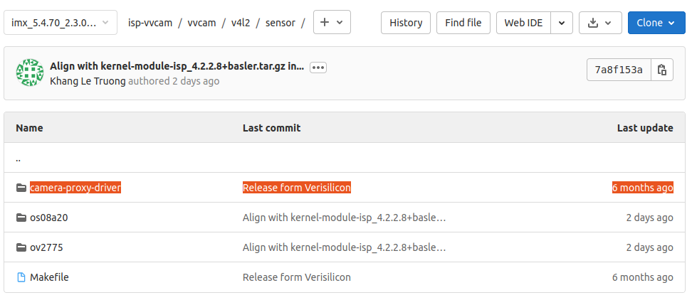

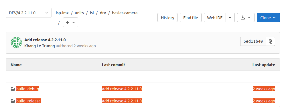

My personal opinion is that in the Basler CEP, aside from the kernel patches and im8-isp service's scripts that are provided as source code, the rest (including the ISP based camera driver for both VVCAM and ISI layers) is pre-built. It is also true in the isp-imx and isp-vvcam frameworks provided by NXP :
- In ISI layer, basler camera driver is prebuilt :
- In isp-vvcam, there's only camera-proxy-driver to 'speak' with Basler camera modules :
So I think the camera is only useful for purpose of demonstrating the iMX8MP's ISP capacity as well as for ones expecting to use the camera as-is while most of us here have the need of customization I guess. But the documentation is quite in high level to be mapped into the current source code.
