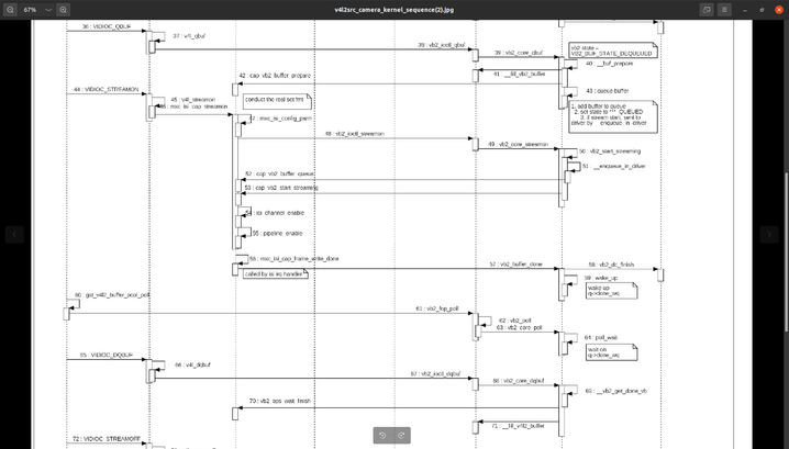

We have gone through the all files associated with the V4L2 Framework.
Queueing of three buffers is done successfully, Stream on IOCTL is also working fine.
But at last of VIDIOC_STREAMON, there is IRQ handler, which is not called in this situation.
and we have stuck in VIDIOC_DQBUF in the above functions.
can you please help me out with this problem?
