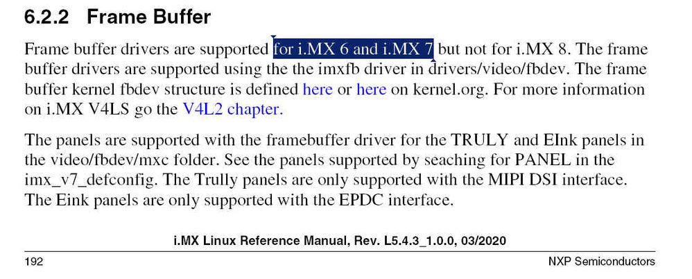

Hi everyone.
I am having a imx8mm evk board and use yocto project to build linux image with BSP 4.14.98.
When i run ./autorun-fb.sh in /unit_tests/Display. I get the following error:

Can anyone help me to test display?

Hi Ho
autorun-fb.sh from mxc_fb_test (frame buffer test for display) supports i.MX 6 and i.MX 7,
as described in Linux Manual
igor
