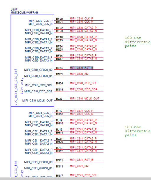

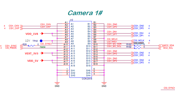

if you need reset camera pins, refer to the imx8qm schematic
MIPI_CSI0_GPIO0_00 and MIPI_CSI1_GPIO0_00 are for reset signal, current bsp set these pins as gpio to reset the camera

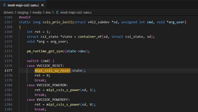

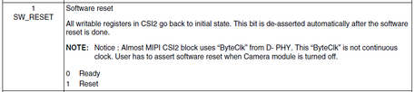

I can find mipi_csis_sw_reset() in csis_priv_ioctl(), it means that can sw reset with external control, am I right?

for mipi_csis_sw_reset() ,which set the bit1 of register MIPI_CSIx_CSIS_COMMON_CTRL
