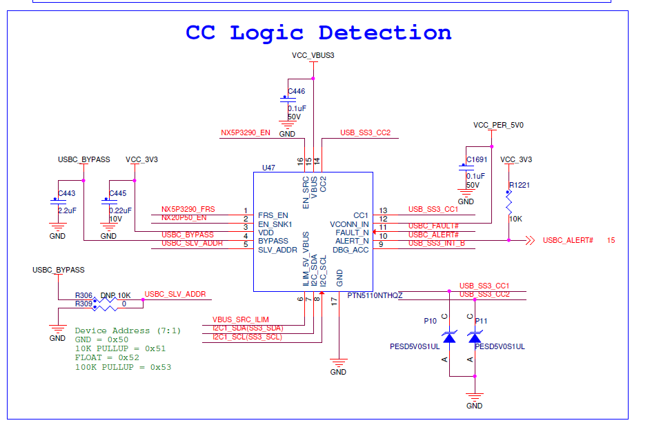

TCPC: Vendor ID [0x1fc9], Product ID [0x5110], Addr [I2C1 0x50]

it should be busy, because 0x50 is used by typec chip.
w/ m4, the bsp doesn't use the typec device and 0x71 pca i2c exp, either.
That is why you can access it.
But it should be a problem for typeC function.  w/ or w/o m4 agent, they all should be busy there.
Not busy, it means typeC chip is not used by Linux.
I will double check it.

BiyongSUN
The m4 i2c agent the behavior the same as physical i2c.
and you log also shows the same.   0x50 is UU.
If it is not UU at 0x50, the type C on board doesn't work.
SW: Binary demo image LF_v5.10.52-2.1.0_images_IMX8QXPC0MEK
HW:i.MX8QXP C0 MEK.
root@imx8qxpc0mek:~# for i in /sys/class/i2c-adapter/* ; do echo $i ;cat $i/name; cat $i/device/of_node/compatible; echo; echo; done
/sys/class/i2c-adapter/i2c-1

BiyongSUN
It is always busy when device is using.
That is way linux prevent unexpected access.
That is normal.
If you really want to access it, you can use force to read it.
Busy is to say, Linux is this device owner. It doesn't matter if any time has data to/from this device.
Now, the problem is m4 i2c agent has problem.
Not always busy is abnormal. Because linux not get the connection with the chip by m4 i2c agent.
The typeC chip is not working normally.
This is need to be fixed. I believe when using m4 i2c agent, the typeC usb port doesn't work.
You treat a normal behaviour  as abnormal and abnormal behaviour as normal.
If you use the sd card flash.bin image w/o m4(imx-boot-imx8qxpc0mek-sd.bin-flash) , will be the same result as flash.in qspi image.
imx-boot-imx8qxpc0mek-sd.bin-flash no m4 partition.  This image uses physical i2c.
imx-boot-imx8qxpc0mek-sd.bin-flash_linux_m4  has m4 partition. This image uses i2c agent.
