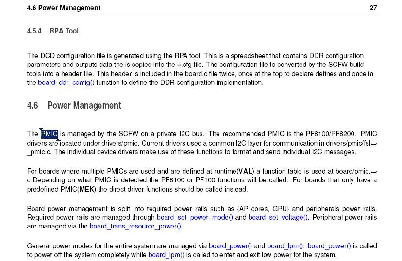

hi,
use IMX8 EVK board, set PMIC power output,after  kernel  is  start。
but PMIC  ->PMIC_I2C,
DTB no PIMC_i2c config ,i donot know how to do?

Hi WANG
pmic usage with i.mx8 series is described in Linux Manual
from Linux 4.19.35_1.1.0 Documentation
SCFW Porting Kit
igor

gravity_one
How does the kernel communicate with SCFW? Using the API: sc_pm_get_sys_power_mode,
Are there any examples of using apis in the kernel?
To modify the SCFW code, can only change the PMIC voltage output before kernel startup.
I think APP can also call API to modify the PMIC voltage output when running linux APP after kernel startup。

igorpadykov
example (SC_R_MU_1A) :
imx_rpmsg.c\rpmsg\drivers - linux-imx - i.MX Linux kernel
https://community.nxp.com/docs/DOC-340335
