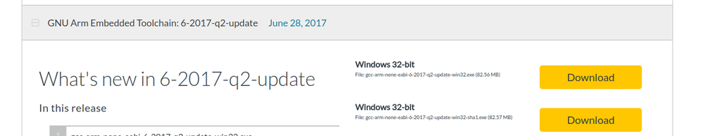

  • Download the GNU ARM Embedded Toolchain: 6-2017-q2-update June 28, 2017 from the ARM website:

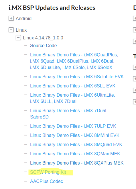

You can get the latest System Controller Firmware Porting kit from the i.MX Software and development webpage:

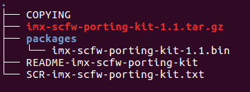

The porting kit is contained under packages, the README contains the instructions to extract the porting kit, basically:
cd packages/
chmod a+x imx-scfw-porting-kit-1.1.bin
./imx-scfw-porting-kit-1.1.bin‍‍‍

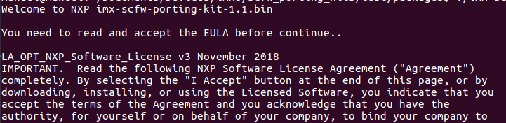

You will be prompted to accept an End User License Agreement:

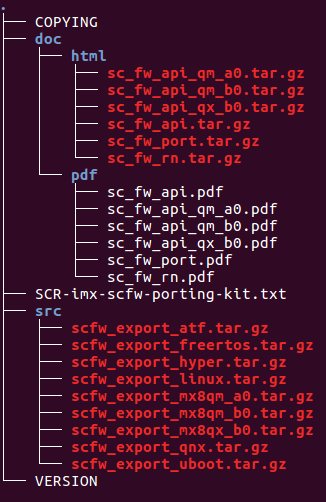

Once you accept the agreement the porting kit will be extracted in a new folder, the folder structure is as follows:
All documentation regarding SCFW is under doc/pdf or in html format if preferred, it is recommended to go over sc_fw_port.pdf.
The porting kits for different SoC variants (QM A0, QM B0 and QXP B0) are under src packaged as tar.gz, all other files are SCFW libraries for different software packages, such as Linux, QNX, FreeRTOS, U-boot, ARM Trusted Firmware, etc...
