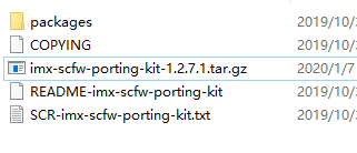

gravity_one
hello,
download SCFW Porting Kit,is imx-scfw-porting-kit-1.2.7.1.tar.gz
tar zxvf  imx-scfw-porting-kit-1.2.7.1.tar.gz,
