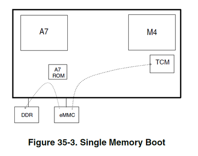

My boot mode is fixed to the single boot mode via resistors.
As you can see, I do not have a QSPI flash on my board. This figure is taken from Reference Manual Pg:1466.

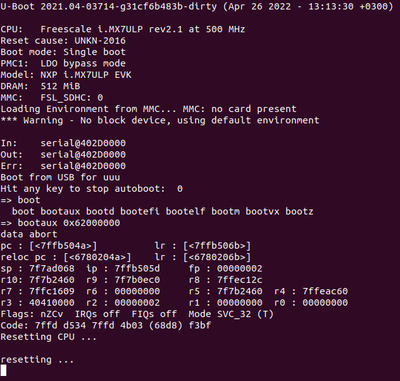

I have compiled my u-boot and downloaded it via the uuu tool in serial download mode. It works fine. I can reach eMMC with "mmc info" command. The next step I have to move on is booting the linux.

Then I run the bootm command to boot from memory. However, the u-boot is stuck at "Starting Kernel".
Question 1: I do nothing about M4 core. Do I have to initialize the M4 core in single boot mode?
If the answer of the question 1 is YES:
Question 2: How can I program M4? I did not expand the SWD pins of M4 out of the board. I can not reach BGA balls. Can I program M4 via u-boot? If yes, do I have to use bootaux command with the patch you mentioned below:
IMX7ULP Bootaux Patch to U-boot
I have done this patch to the u-boot and followed the instructions. But the result is below. Resetting ...
Can you give some detailed explanation about bootaux operation in u-boot?
Question 3: What can be the problem if it is not related to M4?
I think u-boot can not load the kernel to RAM. I have used older or newer versions of u-boot from fslc, the result is same.
  1. Is it about RAM size? or
  2. Is it about PMIC? or
  3. Is it about resetting the A7 core from M4?
  4. Or what can it be?
