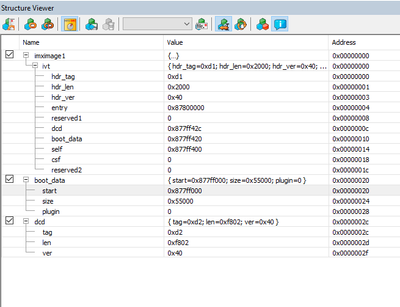

I built u-boot and ran it via Lauterbach Trace 32. Both eMMC and SD card were detected successfully and i could list partitions on SD and make hw partitioning on eMMC. So there is OK from hardware side. I used DDR3 register programming aid v1.1 for generating imximage.conf, i added initialization of eMMC and SD pins to this file.
Then i program u-boot.imx to eMMC (via Trace 32) and SD card (using dd utility) at address 0x400 in accordance with ref manual.

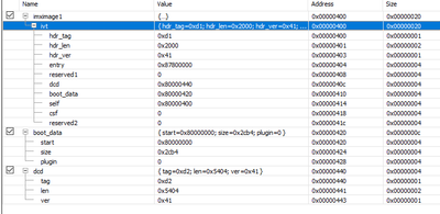

I used mkimage utility to make binary with DCD section (/tools/mkimage -n u-boot.cfgout -T imximage -e 0x87800000 -d leds.bin leds.imx)
I checked IVT and DCD, it had been generated correctly
And app starts at 0xC00 (+0x400=0x1000)
I put and verified this binary to eMMC and it didn't start after reboot.

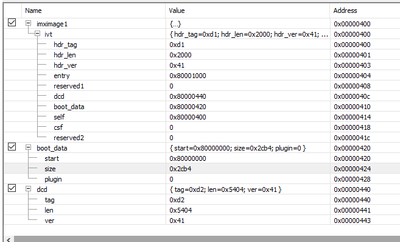

It's not clear enough explained in Reference Manual. That BootData.start means the destination address where BootROM will copy BootData.Length bytes from eMMC starting  from address 0x00000000.
I've changed start address to (application address - 0x1000) and eventually it started from eMMC in configuration entrypoint = 0x87800000

the most examples including U-boot have entry point 0x87800000. I don't understand how my app that is placed at offset 0x1000 will get at this address.
Typical U-boot.imx IVT looks like this
U-boot bin is located at 0x1000, but boot_data says it starts from 0x877ff000
In my previous post i told about a simple project. It had the following IVT and it didn't run from eMMC
I changed entry point to 0x80001000 and rebuilt imx image, after this app could be running from eMMC
Can you explain BootROM behaviour regarding boot_data? Does BootROM copy app (boot_data.size bytes) from eMMC at 0x1000 offset to RAM at boot_data.start address? and then jumps at address ivt.entry?

georgemakarov
Thank you for support.
