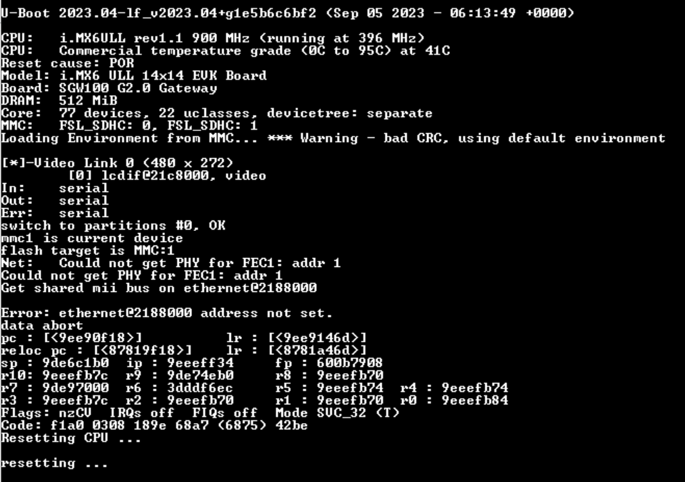

V_Palacio
Contributor V
Hello all,
We have exactly the same issue. No responses from NXP yet?
We are looking into our schematics, and comparing with the EVK.
Our main disadvantage here is that we are using a different PHY chip (KSZ8081RNA instead of KSZ8081RNB)

Net: Could not get PHY for FEC1: addr 1
Get shared mii bus on ethernet@2188000
:-1645649280 is connected to . Reconnecting to ethernet@2188000
prefetch abort
