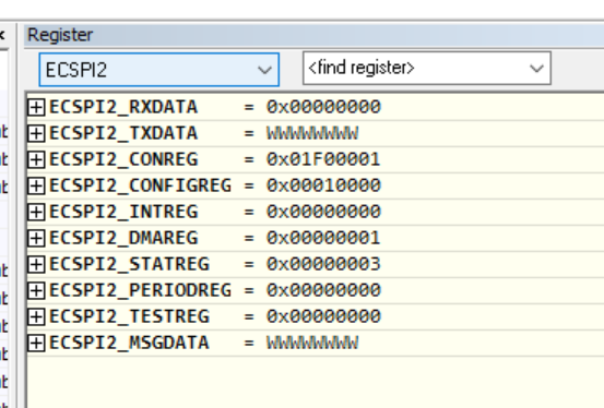

Current i use IXM6ULL SPI as slave mode. But I find the front of 8 bytes in SPI slave send is incorrect.
In this case, bps = 20M, BURST_LENGTH = 32, POL =0, PHA = 0, and SS_CTL[x] = 0. attach SPI configuration.

liqi_wu
This issue is fixed. This question can close now.
The root cause is the SPI burst length are not equal with master and slave.
when I configurate the master SPI and slave SPI burst length is 32bit or 128bit, this issue is disappeared.
