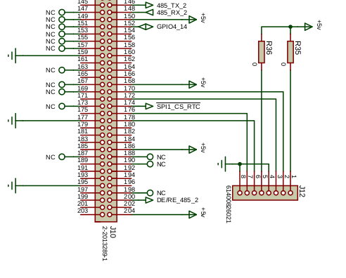

Hi everyone,
I can not detect usb stick on my custom board.
We have developed an electronic card based on the CL-SOM-IMX6UL system-on-module.
Here is the electrical diagram for the usb part de notre card:
we used Pin 170&172 for USB2_D_N , USB2_D_P and Pin 176&178 USB_OTG1_DN, USB_OTG1_DP
I think my device tree is wrong, so would you tell me how to modify it?
related part of my device tree is as follows:

 I checked "dmesg", and "lsusb", but usb stick is not recognized. but i have this message with dmesg :
[351474.050771] usb 1-1: new high-speed USB device number 57 using ci_hdrc
[351474.560820] usb 1-1: new high-speed USB device number 59 using ci_hdrc
[351474.960890] usb 1-1: new high-speed USB device number 60 using ci_hdrc
[351475.362163] usb 1-1: new high-speed USB device number 61 using ci_hdrc
[351475.760674] usb 1-1: new high-speed USB device number 62 using ci_hdrc
[351476.160628] usb 1-1: new high-speed USB device number 63 using ci_hdrc
[351476.560872] usb 1-1: new high-speed USB device number 64 using ci_hdrc
[351477.080729] usb 1-1: new high-speed USB device number 66 using ci_hdrc
[351477.600566] usb 1-1: new high-speed USB device number 68 using ci_hdrc
[351478.000554] usb 1-1: new high-speed USB device number 69 using ci_hdrc
[351478.400572] usb 1-1: new high-speed USB device number 70 using ci_hdrc
[351478.910570] usb 1-1: new high-speed USB device number 72 using ci_hdrc
[351479.420543] usb 1-1: new high-speed USB device number 74 using ci_hdrc
[351479.820486] usb 1-1: new high-speed USB device number 75 using ci_hdrc
[351480.220427] usb 1-1: new high-speed USB device number 76 using ci_hdrc
[351480.730823] usb 1-1: new high-speed USB device number 78 using ci_hdrc
[351481.130351] usb 1-1: new high-speed USB device number 79 using ci_hdrc
[351481.640348] usb 1-1: new high-speed USB device number 81 using ci_hdrc
[351482.040340] usb 1-1: new high-speed USB device number 82 using ci_hdrc
[351482.550393] usb 1-1: new high-speed USB device number 84 using ci_hdrc
[351483.060663] usb 1-1: new high-speed USB device number 86 using ci_hdrc
[351483.580386] usb 1-1: new high-speed USB device number 88 using ci_hdrc
[351483.990364] usb 1-1: new high-speed USB device number 89 using ci_hdrc
[351484.510447] usb 1-1: new high-speed USB device number 91 using ci_hdrc
[351484.920235] usb 1-1: new high-speed USB device number 92 using ci_hdrc

maxime_metayer
Hi Carlos,
Thank you very much for your answer ! Can you tell me how to pulling down the ID pin ?
Thank you in advance.
Romain
2,040 次查看
CarlosCasillas
Hi Romain,
The pulling-down of the ID pin is basically connected this pin to ground. This connection in usually implemented by the external OTG-to-Host adapters.
Hope this will be useful for you.
Best regards!
/Carlos
2,040 次查看
CarlosCasillas
Hi Romain,
The CL-SOM-IMX6UL board is not from NXP, so, you may contact to Compulab in case of requiring assistance configuring the custom hardware to match with the software.
However, as a general recommendation, you may check the following points:
  • The CL-SOM-IMX6UL board provides OTG+Host options, so, first you need to ensure on which port of your board you are connecting the Device. If you are connecting a Device, it must be connected to a Host port, or to a OTG port in Host mode (pulling down the ID pin), otherwise, communication will not be established.
  • If you are modifying the Device Tree, you are modifying the pin assignment (for example, the ID pin); however, it will be also required modify the driver on where it asks for the status of such unassigned pins.
Best regards!
/Carlos
