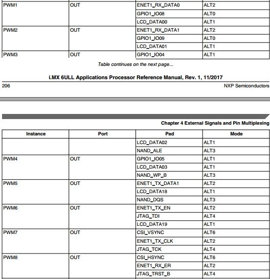

Hello team,
i am using IMX6UL board. in this i am getting problem with PWM.
so could you help how to use PWM pin to control LEDs intensity?
and How to configure settings to use PWM pin?

mayurshankariya
Thank you for your helpful reply, and how can i change mode of PWM_OUT pins using IOMUX controller ? beacuse that PWM3_OUT pin is working for 1) GPIO1_IO04 (mode ALT1) 2) LCD_DATA02 (mode ALT1) 3)NAND_ALE (mode ALT3) these all mode so how to set ALT3 mode?

Carlos_Musich
this is donde in the device tree (.dts). Please take a look to this thread.
https://community.nxp.com/thread/450118
It is not about PWM_OUT but the explanation is the same.

mayurshankariya
thanks for your reply.
i am fresher and new for this board.
i have done same steps which you said above like 32khz settings. but when i change in .dtsi file and try to compile this file at booting image but i am not getting new image of it.
and one more thing in .dtsi file i am not getting this type of node
pinctrl_uart2: uart2grp {
                    fsl,pins = <
                            MX6QDL_PAD_EIM_D26__UART2_TX_DATA       0x1b0b1
                            MX6QDL_PAD_EIM_D27__UART2_RX_DATA       0x1b0b1
so can you tell me please what is use of these node? and i have to write this node in .dtsi file for PWM3_OUT and what is 0x1b0b1 address?
