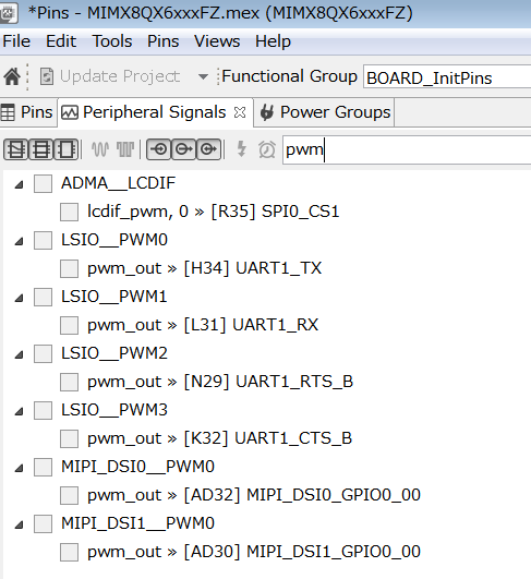

i.MX8QXP is supporting 4x PWM channels according to description from "Table 1. i.MX 8QuadXPlus/8DualXPlus advanced features in IMX8QXPAEC Rev.0".
When I search PWM pins by Pins tool v5.0, seven pins appeared such as below figure.
It means that PWM0 is able to use only exclusively.
Ex : In case of MIPI_DSI0 is assignment to PWM0, ADMA_LCDIF, LSIO_PWM0 and MIPI_DSI1 can not use PWM0.
Is my understanding correct?

   i.MX8QX supports following  (separate) PWM channels:
1) 4 general purpose PWMs (in the Low Speed I/O (LSIO));
2) each of two MIPI DSI systems has own PWM to control the remote displays;
3)  PWM of the ADMA, intended for the LCDIF.

Hi Yuri,
I appreciate your support. I got it.
