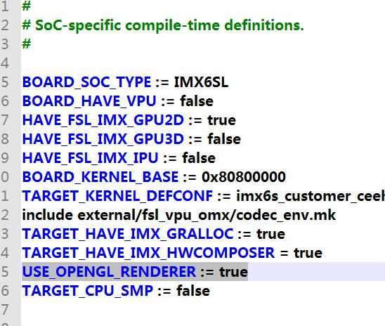

Hi,everyone,
     I met one problem about imx6sl GPU:
          I want to call the hardware rendering to increase the refresh speed,so,I set
     USE_OPENGL_RENDERER as true(default is false) in file "device/fsl/imx6/soc/imx6sl.mk":
   then recompiled the whole android system.
    After upgraded the firmware,the devices cannot bootup,instead of,it shows below errors:
E/AndroidRuntime( 2417): FATAL EXCEPTION: main
E/AndroidRuntime( 2417): Process: com.android.launcher, PID: 2417
E/AndroidRuntime( 2417): java.lang.RuntimeException: eglConfig not initialized
E/AndroidRuntime( 2417): at android.view.HardwareRenderer$GlRenderer.loadEglConfig(HardwareRenderer.java:1142)
E/AndroidRuntime( 2417): at android.view.HardwareRenderer$GlRenderer.initializeEgl(HardwareRenderer.java:1117)
E/AndroidRuntime( 2417): at android.view.HardwareRenderer$GlRenderer.initialize(HardwareRenderer.java:1057)
E/AndroidRuntime( 2417): at android.view.ViewRootImpl.performTraversals(ViewRootImpl.java:1731)
E/AndroidRuntime( 2417): at android.view.ViewRootImpl.doTraversal(ViewRootImpl.java:1181)
E/AndroidRuntime( 2417): at android.view.ViewRootImpl$TraversalRunnable.run(ViewRootImpl.java:5906)
E/AndroidRuntime( 2417): at android.view.Choreographer$CallbackRecord.run(Choreographer.java:761)
E/AndroidRuntime( 2417): at android.view.Choreographer.doCallbacks(Choreographer.java:574)
E/AndroidRuntime( 2417): at android.view.Choreographer.doFrame(Choreographer.java:544)
E/AndroidRuntime( 2417): at android.view.Choreographer$FrameDisplayEventReceiver.run(Choreographer.java:747)
E/AndroidRuntime( 2417): at android.os.Handler.handleCallback(Handler.java:733)
E/AndroidRuntime( 2417): at android.os.Handler.dispatchMessage(Handler.java:95)
E/AndroidRuntime( 2417): at android.os.Looper.loop(Looper.java:136)
E/AndroidRuntime( 2417): at android.app.ActivityThread.main(ActivityThread.java:5017)
E/AndroidRuntime( 2417): at java.lang.reflect.Method.invokeNative(Native Method)
E/AndroidRuntime( 2417): at java.lang.reflect.Method.invoke(Method.java:515)
E/AndroidRuntime( 2417): at com.android.internal.os.ZygoteInit$MethodAndArgsCaller.run(ZygoteInit.java:809)
E/AndroidRuntime( 2417): at com.android.internal.os.ZygoteInit.main(ZygoteInit.java:625)
E/AndroidRuntime( 2417): at dalvik.system.NativeStart.main(Native Method)
W/ActivityManager( 2260): Force finishing activity com.android.launcher/com.android.launcher2.Launcher
(for more informations,please see the attachment file:imx6sl_gpu_error.log )
  Does everyone know why? how to solve it?
Thanks very much!

Hi wen,
It looks like a Launcher wallpaper issue, apparently engine does not realize that should be using OGL rendering.  are you using the default android wallpaper? if not please try it with it.

xrztech_wen
Hi, Bio,
    The app had hw acceleration attribute:
          android:hardwareAccelerated="true"
    so I think it  was not the app problem,and the error was made from "HardwareRenderer.java".
Thanks very much!
BTW,
    1.The attachment file is my app file;
    2.About the "HardwareRenderer.java" file,we didn't make any changes.
