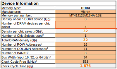

One other question is about Register Programming Aid v2.4 for IMX6DQ. We have 4 DDR3 chips all connected to CS0 and each of which is 8Gb (i.e. 16 bit row, 11 bit column and 8 banks). This should indeed give 1GB per chip since 0x10000 * 0x800 * 8 = 1GB. So the DRAM configuration in XLS looks as follows:
However, when we load from this XLS generated INC file to DDR Test tool, it prints the following summary:
It is unclear from where this 8192MB appeared as one would expect to see 4096MB?

As i mentioned in the previous post i used the following configuration in XLS file of Register Programming Aid 2.4.
However, i could not use the generated INC file to calibrate the DDR further because the DDR Test tool  hangs and from USB sound I assume that this is due to restart of attached USB controller (maybe due to restart of device). This is the log message at which DDR Test tool 3.0.0 stops:
        DDR Stress Test (3.0.0)

As one can see the tool calculates the density per chip select as 8192 MB, but it should be 4096 MB.
We have 4 DDR chips using a single CS0 and each of which is 1 Gb (with 16 bit row, 11 bit column and 8 banks).
So the wrong density per chip which the DDT Test tool calculates may be the reason of its hanging.

But i am inclined to think that the generated INC file is correct because when using its data for JTAG debugging, i can finally see that some chunks that are downloaded into DDR the result of the verification is OK.
So, it seems that it is simply because of uncalibrated INC file data that i use to download the u-boot binary gives for some downloaded chunks "Verify failed". Unfortunately, i cannot calibrate the DDR memory with generated INC neither with DDR Stress Test tool (for the reason already mentioned) nor with JTAG variant of DDR Test tool. Both ways fails.
Is it possible to somehow convince the DDR Stress Test GUI program to correctly calculate the DDR density?
