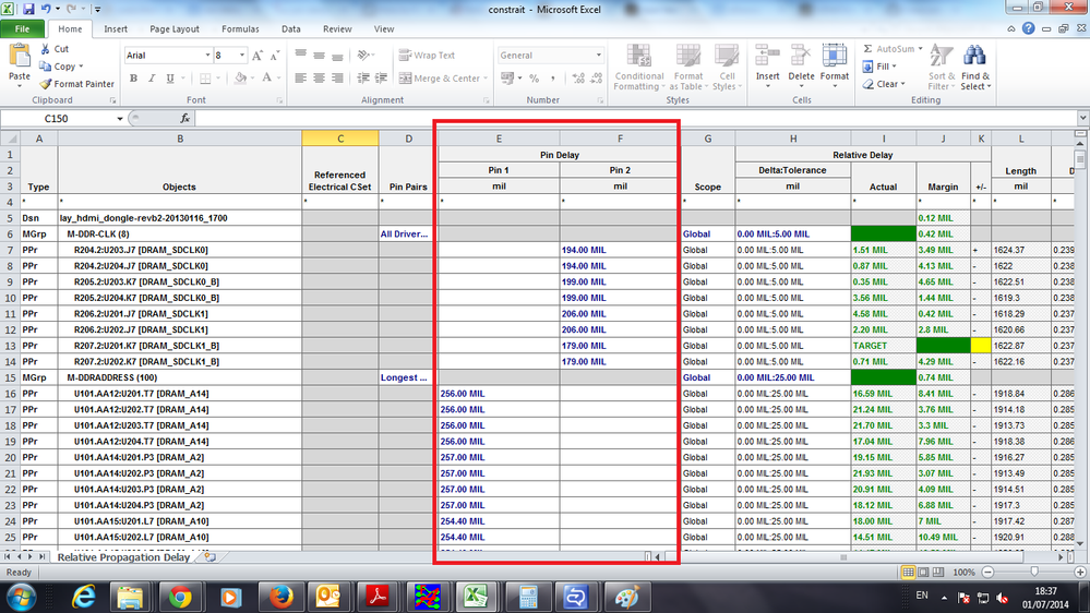

          In this Design Board file constraint manager, Pin delay is included for calculating total trace length.
     Please let us know answer for below queries
          1. we should consider pin delay for calculating total trace length?
          2. What is the processor pin delay for Data, command & control pins?
          3. Whether we should consider DDR3 SDRAM chip pin delays? We are using MT41J256M16RE-15E:D in our design. what will be pin delay?

  Usually we do not provide information about internal traces.  Actually customers can
ignore the lengths of internal bonding wires as they are really very short.
For simulation, customers only needs to consider signals trace length on PCB.
Let me remind, IBIS model includes internal traces and general approach is just to follow
requirements of the design checklist and PCB layout recommendations, for example, provided
in the "Hardware Development Guide for i.MX 6 ...".
