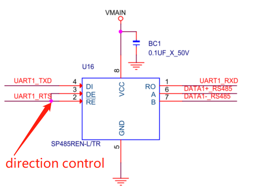

Dear sir.
    we board have four uart work with RS485 (UART1 UART2 UART3 UART5)  kernel 3.14.52
we modify the file : driver/tty/serial/imx.c
the uart look seem work ok when only one uart work
but more than one rs485 uart work together, will can't read data when uart A is r/w data during B is r/w data.
how to fix.
Had Fix issue.
   the point is tx chang to rx, must wait tx send data complete.

lifusong
Hi sir.
  thanks for your replay.
  we had fix this issue.
