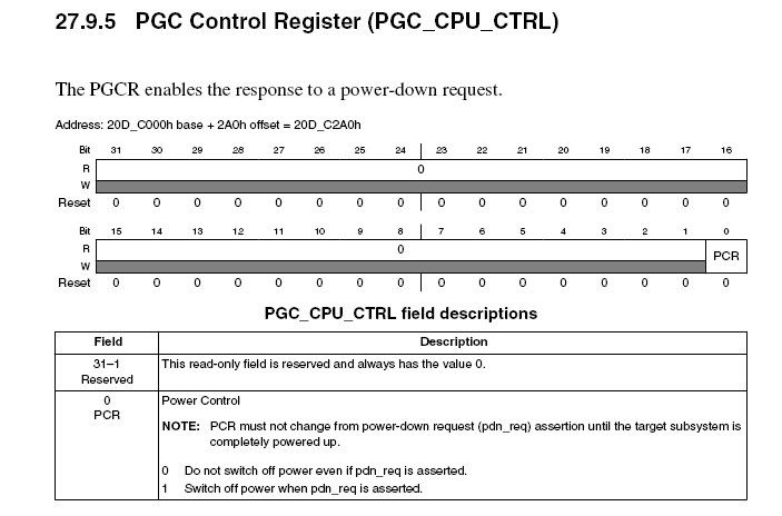

We are doing power management in Linux(L3.0.35_4.1.0_130816_source) for imx6 board.
As part of power management, we want to power off arm core or gate off arm core during suspend.
But we cannot find the code portion to do this in Linux source. Is this feature is implemented in Linux code?
In one portion (mxc_cpu_lp_set function)  ARM_POWER_OFF case, we can see the code to power off the arm core.
But I am not seeing arm power down request bit similar to VPU/GPU(gpu_vpu_pdn_req) to switch off the arm core in imx6.
Can you please help to identify the arm power down request bit?

Hi anoop
actually mxc_cpu_lp_set function  ARM_POWER_OFF case is
pdn_req to switch off the arm core, it is implemented in
register PGC Control Register (PGC_CPU_CTRL)
IMX6DQRM  sect.27.6 Power Gating Control (PGC) gives usage :
PGC power down sequence:
• CCM sends power down request when the chip is about to enter stop mode. The user
should define which modules will be powered down (PGCR registers of
corresponding PGC module, bit 0).
