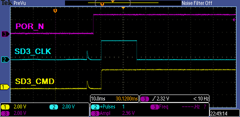

Hello All,
We have a custom board based on iMX6 quad core processor. It is designed to boot from eMMC, boot setting is from eFuses.
Processor: IMX6 Quad, revision : C
eMMC : MTFC16GJDEC-4M IT ( eMMC v4.41)
uSDHC port : USDHC3
SRC Boot Mode Register 1: 0x00005060
SRC Boot Mode Register 2: 0x30000011
Problem :
We see majority of boards boots as designed. But there are random failures on one or two boards per hundred( 1 to 2% only).
We read the system SRC boot mode registers.Its readings are same for both the working and non-working boards.
The following signals from i.MX6 are captured for working and non working boards  and is as below.
  • POR_N ( reset pin)
  • SD3_CLK ( clock to eMMC)
  • SD3_CMD (CMD line to eMMC)
The waveforms of both working and non working boards  are as below
Working Board Waveforms:
Non Working Board Waveforms:
I expect SD3_CLK to toggle at 347.22 KHz( or 400KHz) as IMX6 attempts to boot. After initial CMD exchange between eMMC this clock should switch to 20MHz.
We can see this happen working in correct boards.
In non-booting boards after POR, CLK line stays high for around 16mS and then goes low, its not toggling then and IMX6 is moving to serial downloader mode.
I tweaked the Boot Mode pin settings to serial downloader mode, and observed that SD3_CLK is not changing at all.
This makes me feel that, i.MX6 understands that eMMC is the boot device and attempts to boot from eMMC. But it fails to complete the boot process..???
I extended  POR_N so that if the booting problem was due to the timing deviation of internal 200KHz oscillator, it should go away, but there was no luck.
Any help to understand what is happening is really appreciated!!

igorpadykov
Hi Sonu
reason may be erratum ERR006282 ROM code uses nonreset PFDs,
which is fixed in rev.1.3 silicon (revision D). To check one can attach jtag debugger
to failed board and output on CCM_CLKO1 (pad GPIO_0 ) clock usdhc3_clk_root divided by 5,
figure out there is(or not) output of usdhc3_clk_root which was sourced from PFD396.
igor

ndsonu
Hello Igor,
Thank You!
On the non booting boards we are not getting the clock but on booting boards we are.
So we are now trying the work around by enabling the WDOG_ENABLE bit fuse.
Thank You.
Sonu

ndsonu
Hello Igor,
The work around mentioned in Freescale erratum is not working for us.
This make me a bit skeptical on whether "ERR006282 ROM code" is our real issue.
Infact our non booting boards never boots.
Is there a possibility that "ERR006282 ROM code" will occur on all power ups?
Is there any way to reset PFD396 from JTAG ? ( I don't know whether this question is silly!)
Thanks for your support.
Sonu

igorpadykov
Hi Sonu
sorry, if you answered that: "On the non booting boards
we are not getting the clock", this does prove ERR006282 erratum.
How did you connect wdog, it should provide reset pulse on MMPF0100
PWRON also, so whole system with pmic was reset, check
U507 on spf-27392 Sabre schematic.
PFD is described on
http://cache.nxp.com/files/32bit/doc/eng_bulletin/EB790.pdf
i.MX6 D/Q L3.0.35_1.0.3 patch release
igor

ndsonu
Hello Igor,
Thanks.
I now understand our issue is ERR006282 erratum.
I changed bit 18 of "CCM_CSCMR1" to select USDHC3 clock from PFD352 and i could get the clock!
Now my worry is on the work around.  I was wondering whether watchdog timer reset option will work for us.
We see that our board is not booting on all power ups and resets.
So even if the watchdog bites, it will be another reset and board will not boot.
Is there any difference between a watch dog bite reset and manual pulling down of PMIC power ON pin reset?
Any comments?
Thank you for your replies.
Sonu

igorpadykov
Hi Sonu
difference is that PMIC power ON resets both pmic and processor,
while watchdog only processor. So in ldo bypass case (core voltages
are lowered), pmic voltages will be insufficient to boot-up processor
(at reset processor has ldo enabled configuration).
