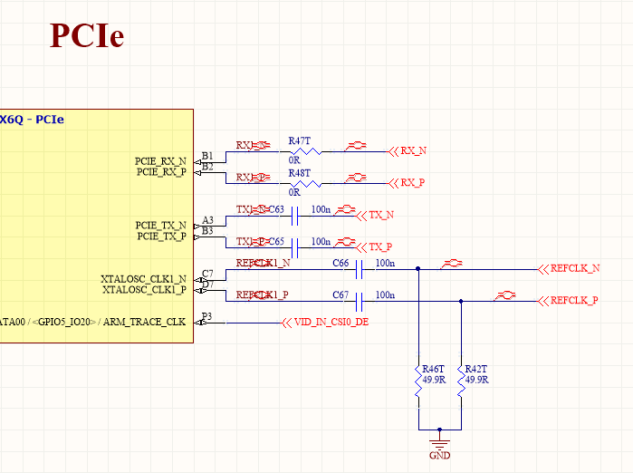

1) 125 MHz is the correct frequency for reference input. Standard files from your board should ensure normal operation, provided one endpoint is connected.
2) Using an internal clock can cause problems with external devices. For example when using the PCI bridges.
see IMX6SDLRM 50.5.1.2 Reference Clock Frequency Selection.
In my case, it was not possible to use internal clocking when connecting endpoints through the bridge.
At the same time, when one endpoint was connected, everything worked smoothly.
3) I did not check, but judging by the previous post no
4) When designing the kernel, such a clocking case was not taken into account. What you see in the clock branch of the kernel is calculated values, and not measured.

1) If I'm not using external clocks are there any method to change PCIE clock ? My board is showing PCIE clock 125MHz. What is the correct clock PCIE clock for imx6q ? Can we change it to 100MHz with out using external clocks ?
2) My custom hardware is based on nitrogen 6 max development board. I’m using Kernel – Linux-boundary 4.1.15 I’m using nitrogen 6 max uboot. What is the PCIE clock frequency for this hardware(Nitrogen 6 max) ? From where we take PCIE clock ? Is that from SATA ? If I need to get PCIE clock from SATA what should I do for dtsi and uboot ?
3) Both SATA and PCIE are getting clocks from LVDS clock source ?
4) When I add following changes my pcie clock shows 250MHz. Why is that ?

My custom hardware is based on nitrogen 6 max development board. I'm using Kernel - Linux-boundary 4.1.15. I used following hardware pull down configuration for PCIE clk. But I'm getting PCIE link up problems for each and every hardware in different manner, some hardware working well. Are you aware about nitrogen 6 max uboot and above kernel ?
According to your above description I could edit my imx6qdl.dtsi file. Attached here with.
But I couldn't find a place to add clock dependents. I managed to add it to imx6qdl-nitrogen6_max.dtsi file attached here with. Could you please tell me whether it's correct or not ?
And also the file you have mentioned pci-imx6.c is different from the kernel I'm using (Attached here with). Is that okay to replace completely that file ? Can you describe how this should edit according to my kernel ?
I just edit the dtsi files and ran kernel. Then kernel shows pcie ref clk as 250MHz. Why is that ? Will that correct after changing pcie-imx6.c driver file ?

I use a custom board with Tq module.
13,298 Views
maxmar
With some debug I see that the problem is caused by the IMX6QDL_CLK_SATA_REF_100M in dts file and the code in the pci-imx6.c.
If I add in the dts file only the options fot pll6 bypass the kernel start.

Where is the correct value of the register CCM_ANALOG_PLL_ENET ? with the program devregs I see the value 0x97001

alfredk
Hello
In dts files for this board SATA module enabled?
CCM_ANALOG_PLL_ENET contains an invalid value.. Can you send your files dts for viewing?
Alfred.
13,293 Views
maxmar
SATA module is enabled. I attached the dts file.
Thank you for your support.
13,293 Views
alfredk
Hello.
If the configuration allows. Try downloading with SATA off. So we will probably solve the problem
Alfred
13,293 Views
maxmar
Unfortunately SATA is mandatory for this application.  Whre is the correct value for CCM_ANALOG_PLL_ENET ?
13,293 Views
alfredk
Hello!
Correct values is 0x80016002, 0x16002 and so on. See brief from Charle Powe i.MX6Q: Using an external reference for PCIe
Here is more detailed. The main bits as indicated are BYPASS_CLK_SRC (bits [15:14]) and BYPASS bit (bit 16).
And see for board clk info : /sys/kernel/debug/clk/clk_summary table-file.
Alfred.
