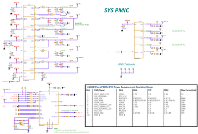

We are working with a custom board based on the i.MX8MP, with a PMIC circuit similar to the EVK.

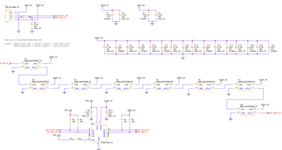

We have connected an LED board to the GPIO3_IO16 pin, as shown in the attached design, along with the PMIC circuit. However, we are observing an issue: there is leakage power to the LED board even when the system is in a shutdown state. Out of the total 8 LEDs, one LED still glows faintly during shutdown.
Could you please assist us in identifying and resolving the cause of this leakage power?

What kind of LED board are you using? Could you share us how it connect to i.MX8MP , you'd better share this section of the shematic to us

Hi @Rita_Wang Led Schematic attached bellow

Could you share use all the i.MX8MP design to us? We need to check your design, to see the pins design in your side? Thanks

how it connect to i.MX8MP? Could you also share it? Thanks

We have connected DIN pin of LED board to the GPIO3_IO16 pin.
