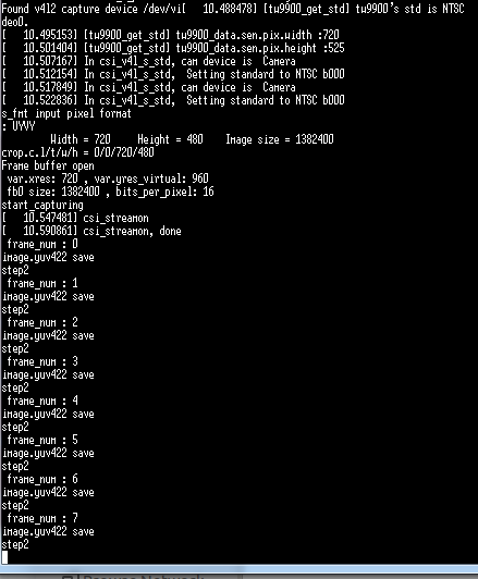

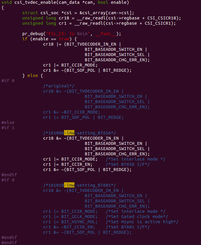

I made Tw9900 driver. and It is working
currently, I have a problem.

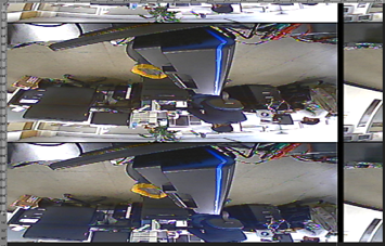

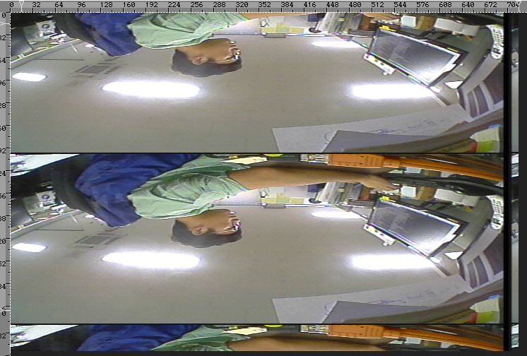

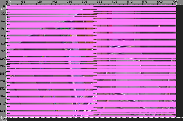

This picture is dumped from csi buffer Using DQueue
 when  It was  "csi_buf_stride_set(cam, 720); " "csi_deinterlace_enable(cam, false);" in csi_v4l2_catpure.c, I  dumped picture.
  when I revise  "csi_buf_stride_set(cam, 0); " "csi_deinterlace_enable(cam, false);" in csi_v4l2_catpure.c, I  dumped picture.
I think CSI driver dosen`t  find start of frame.
let me know how to resolve this problem.

Hello Lee,
     Your application is very similar to ADV7180 supported by our Sabre AI board and it's BSP, ADV7180 can't also report the sequence  of frames. The issue you encontered maybe caused by the following reasons:
(1)There is a mismatch between the video standard TW9900 output and standard CSI recieves.
For example, The video standard TW9900 output is NTSC, but on CSI side, standard for revcieving is PAL, so please check and confirm the item.
(2) Power up Sequence
TW9900 should be powered at first, then CSI interface.
Hope above information can help you!

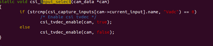

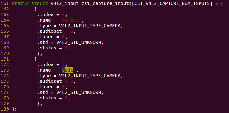

3) In CSI_v4l2_capture.c,
 I think if we use VADC,  we select csi_capture_inputs[1] and if we use TW9900,  we select csi_capture_inputs[0].
because  in csi_input_selct  func, It enables tvdec(vadc) depend on csi_capture_inputs.name.  So if  we use TW9900,  we select csi_capture_inputs[0].
Is it right?
4) In fsl_csi.c,
 we planed TW9900 output format is BT656 and interlaced mode. so, I revised FALSE case in csi_tvdec_enable func .
   Is it right?
5)  In csi_v4l2_capture.c,
     I found setting bufstride and deinterlaced_mode, deinterlaced_enable  in csi_v4l_s_std function .
we tested original source. but application is stopped. I don't know why application is stopped.
so I revised it
and i captured from tw9900(Bt656, interlaced ).
but caputred image is not corrected. What is wrong?
